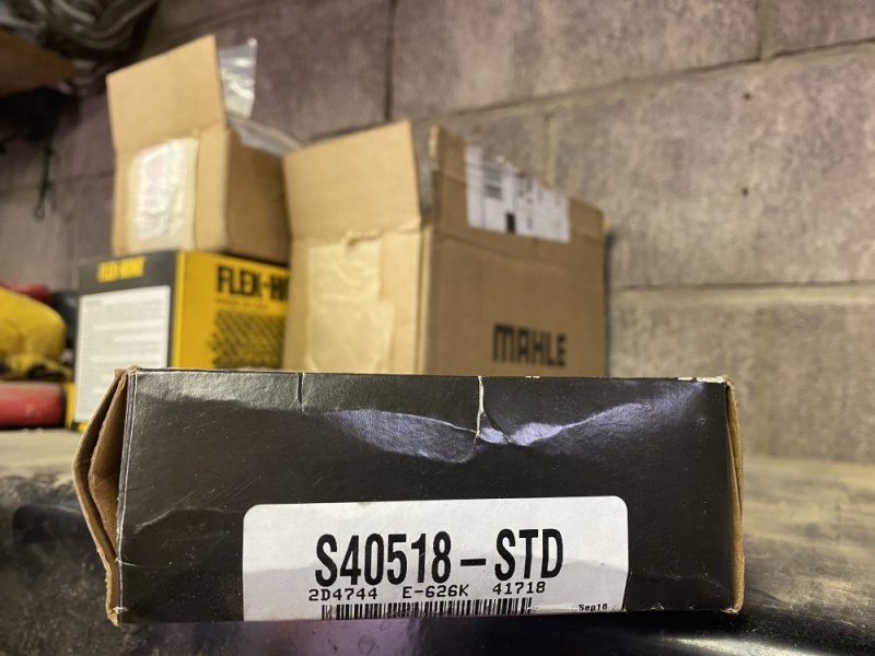

Just to help everyone here what was the P/N of the rings you got so if we find that P/N we'll know it is not the cheap ones?
