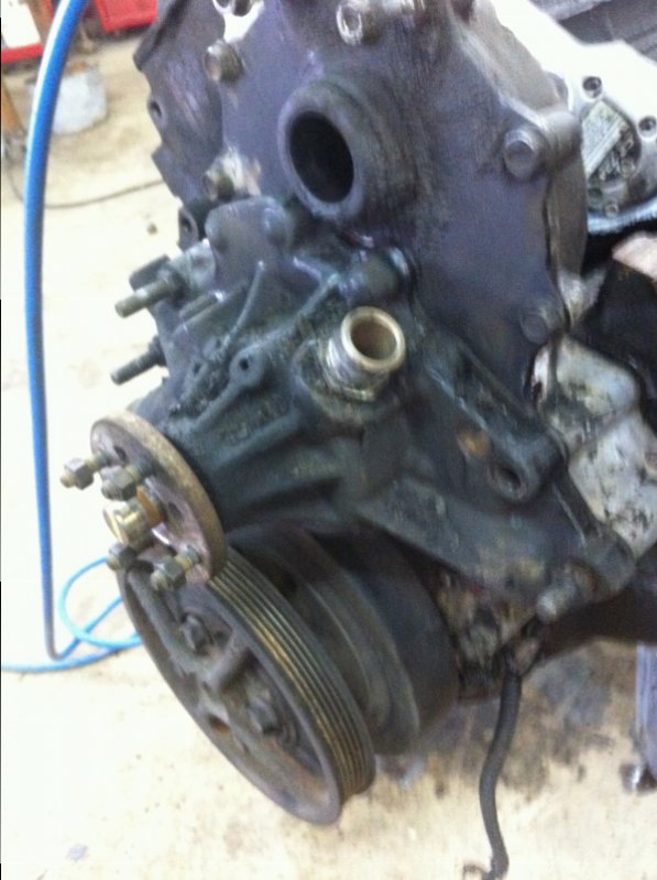

Not the best pic but all the bolts on the backing plate have to come off, the vac pump should not matter.
The vacuum pump bracket is over the one stud on passenger side I took the nut off then behind the bracket there is another nut.
