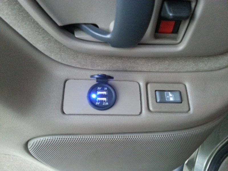

I have a crew cab 1999 K2500 OBS and am sick of my kids needing run cords up front to charge their phones or tablet while we're driving. I never use my ash trays in the back doors. So I bought 2 USB charging ports, grabbed some plastic, and painted them to match the interior, There is already power at the power window switch so I powered them from there. The only thing is if you put the window lock on from the master switch it kills power to this also. This should work on Suburbans also.

Hey just thought of something. When I was looking to do this, I was originally going to wire it to the courtesy light in the door. They have 12 volts all the time. You would just need to run a ground. I put LEDS in all of my interior lights, so I knew the circuit would be fine running it. But opted to do it this way so that the power was off when the key was off. So really, you could run it off the courtesy light and if you wanted, could put a switch next to it to shut it off, or just leave it on all the time. I doubt that little LED would kill the battery. Actually, when I was looking at buying these I think I saw some that didn't have a light. They wouldn't draw anything unless it was plugged in. Then you would still have control of the window lock.

Because power and ground were 4" away in each door and if for some reason I would want to cut power to them I can just flip the window lock switch. You can mount them wherever you want, these work great for us mounted in the doors because most trips are longer ones heading to campgrounds or going to visit Grandparents. I don't like cutting holes and having switches all over my truck. So this worked awesome because it can be put back to stock if someone ever wanted too.

Hey, if you think it's easier running a fused power under the carpet, great! But being the windows are already fused and these draw hardly anything it's pretty pointless to run a separate fused wire. Unless you are mounting them somewhere else. I was going to mount them at the bottom of the rear seat. There is a hole that you would have to drill out to make it fit, but then I was thinking they'd hit it with their foot and snap the USB cable off. And yes I did make mine the point of discussion. And I also never said this was the only place they could be mounted. The point of the thread was to add an accessory to our trucks that is on new cars. Where I mounted mine seems to work good.
