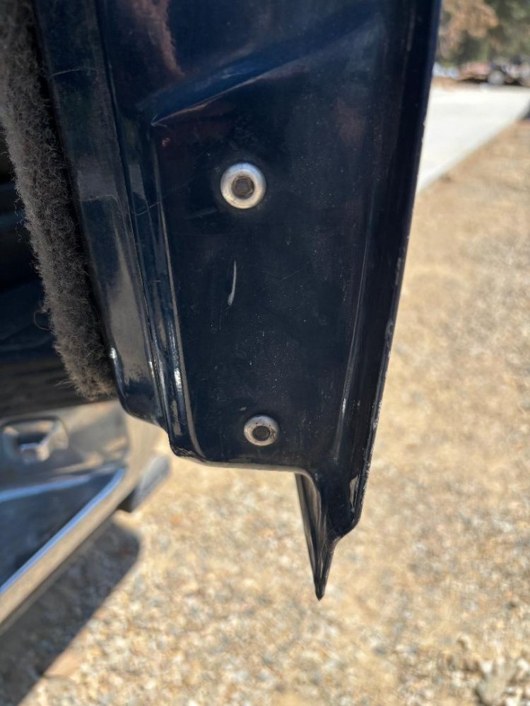

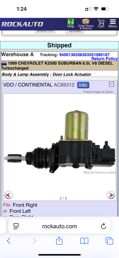

Rear barn door lock actuator no longer works, so I have a new one on order. Question is how to remove the existing? Actuator is bolted to a bracket using the 4 small bolts holding the actuator together. The bracket is rivet to the door. Should I try to remove the bolts holding it to the bracket, or should I just drill out the rivets and bolt it back in place?
make easier work by drilling out the rivets. I don't think removing the inside panel will give you much access other than a small hole to reach your arm in there! while you have the bracket out, if you have any 1/4" nut-zerts left over, use them on the bracket before going back in.
9 times out of 10 the actuator just needs lube. all 4 doors on my 95 needed help. you had to hit the button 4-5 times in ether direction to lock or unlock them especially the rear doors. lubed them up along with removing what used to be a rubber boot that had crystalized around the part that moved in and out fixed them.
