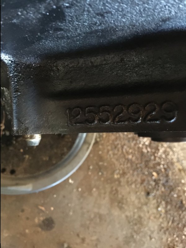

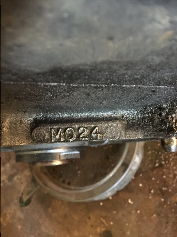

These are the numbers off the back of my block do they mean anything special? This is my first diesel engine im used to gas
929 is your block #, one of the better ones, I think the first is your date code, a search may yield results. Someone will know the codes.
