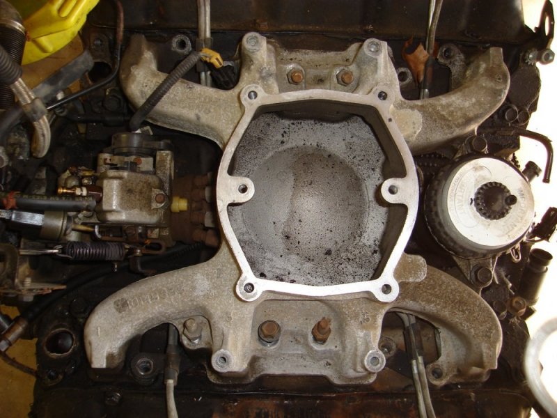

Can I avoid removing the intake and lines, and just pull the plenum hat part. I'd old one like to avoid it as I'm not pulling injectors.
I don't think it would be easy. Might not be possible. You have to get to the bottom of the pump to unhook the injector lines so it would be worth getting everything out of the way just for room to work in there. You've already done one pump so you already know what you are getting into.
Believe it or not, with a little custom tool, it is possible to un-hook the injection lines from the back by removing the FFM and going in from the back, but it's quickest and easiest just to rip the intake off. takes 10 minutes.
