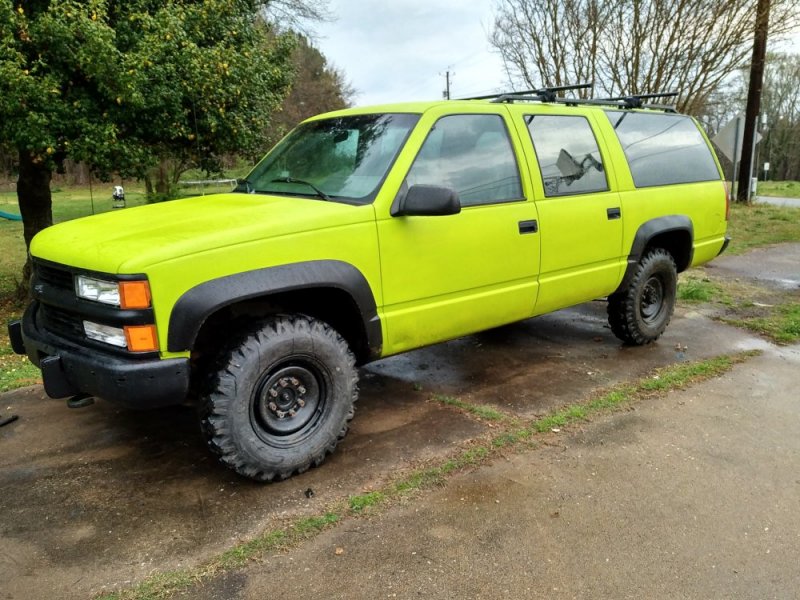

This Suburban was my family vehicle and then my farm truck and then it sat after the IP failed 2 years ago. When I decided to get it running again, I vowed it wouldn't become a hobby vehicle. But I caved.
Now it's slated to be the adventure truck to get me and my kids up into the mountains more often.

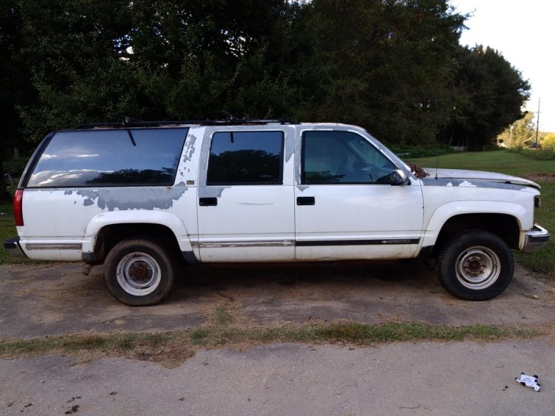

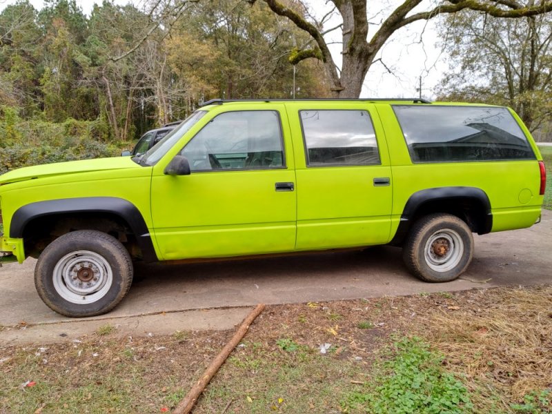

I had to deal with the standard flaking GM White. Wanting to keep the budget low, I opted for DIY full coverage with tintable Raptor Liner and I'm pretty pleased with the results. We decided on a shade that's pretty close to the old (and new) Ford Grabber Lime. Hardly perfect, but it was an easy process and is forgiving stuff for me and a couple of teen boys with no bodywork experience between us. I can't say much on durability yet but, with adequate prep work, it has gripped well and coverage is decent. Definitely a good 10 footer.
Before:After:
I still have some touch up work to do where coverage was a bit thin and some trim and hub painting to do. Next the plan is for a set of black Chevy steel 16s - or maybe HMMWV 16.5s - with MTs in the 32-33 range.

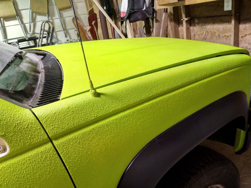

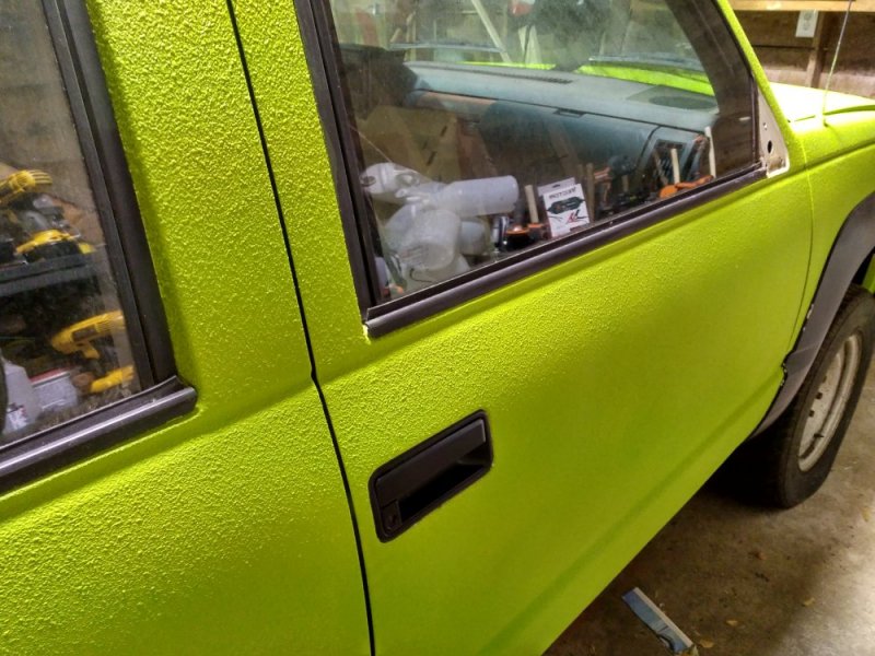

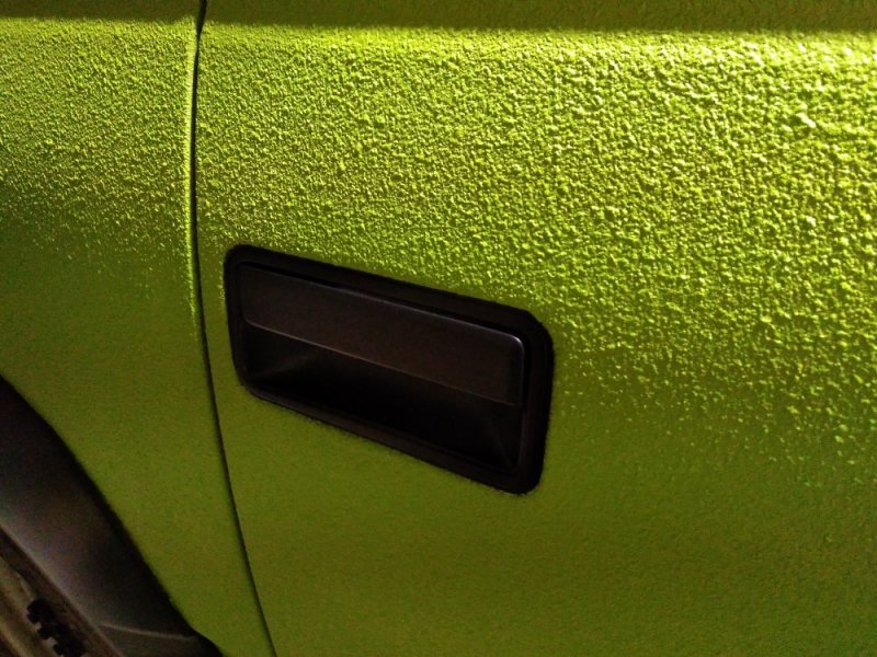

do some close up pics if you would of the paint- since the 10footer rule is in effect and you seem about 20’ away. No hatin’ just wondering.

Ha! Good point. I'll take some closer shots to show texture, coverage, etc. and will post along with some lessons learned.
Detail pictures as requested:
Some things I like about the Raptor product:
  • Covers over a multitude of sins with no wet sanding necessary
  • Long working time (~60min from when you add the hardener)
  • Prep is straightforward and filling is not required (though certainly can be done)
  • No high-dollar equipment necessary, just a decent compressor (see below) and a Schutt gun
  • All mixing is done in the bottle
Some lessons learned:
  • Make sure your compressor can hit the desired working pressure BEFORE you start spraying (probably common sense to most of you). My texture is more coarse than I wanted because I could only maintain 50-55 psi with my compressor
  • Next time, I will use 10% urethane reducer in the first coat to ensure good spread/coverage, and then I'll lay on the texture
  • I'm regretting that I taped the weather stripping instead of removing it
  • It's important to pull the tape within an hour of last coat
  • Good lighting is needed to ensure you've hit all the necessary spots, especially with a low contrast color
  • Spending more for good tape is worth the cost...
