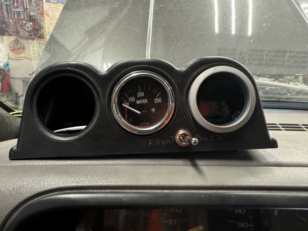

Recently I was wanting to fill a compartment on a three gauge pod that I have setting atop of the dash of My truck.
The gauge to the right is fuel pressure, hooked through the toggle switch to, as suggested by @Will L. , monitor the pre and post fuel pressures of the FFM fuel filtering system by utilizing two pressure sending units.
The center gauge position is for the right rear cylinder head temperature, the hot spot on the 6.5 engine.
The left position I had suggested running a transmission pressure gauge.
Then it was suggested to run turbo pre and post drive pressure gauges, both on one gauge.

Any how thats the plan, and, more pics will come after I get the rest of the supplies and begin to plumb this gauge in.
