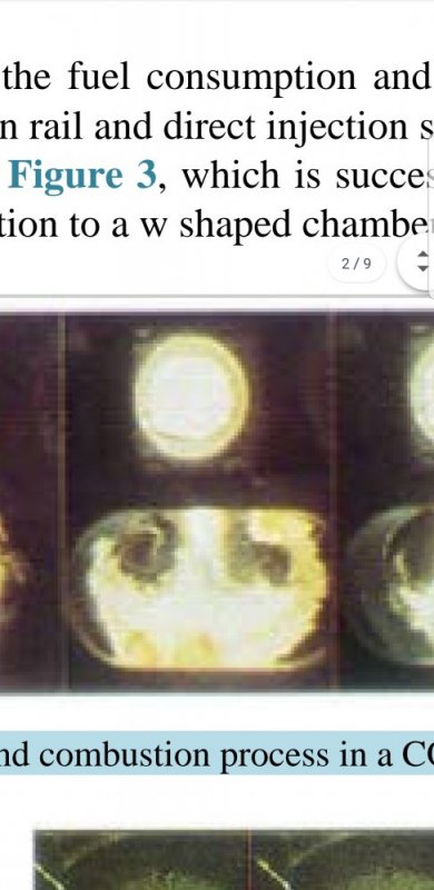

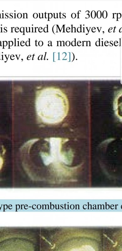

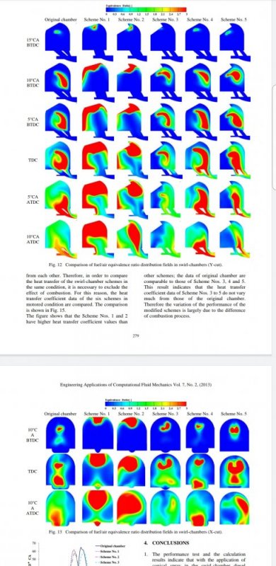

I have some pictures I posted on my precup thread that shows some of the combustion process. Our cups are like scheme 1 and 2.
