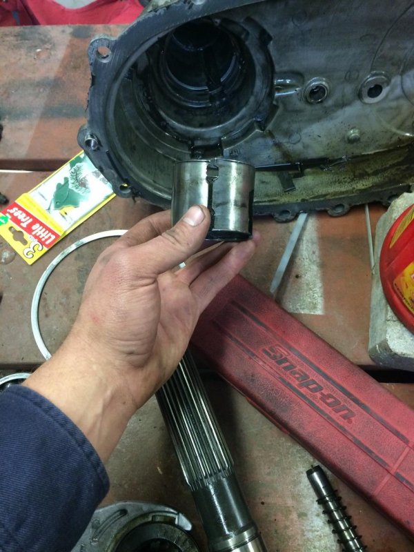

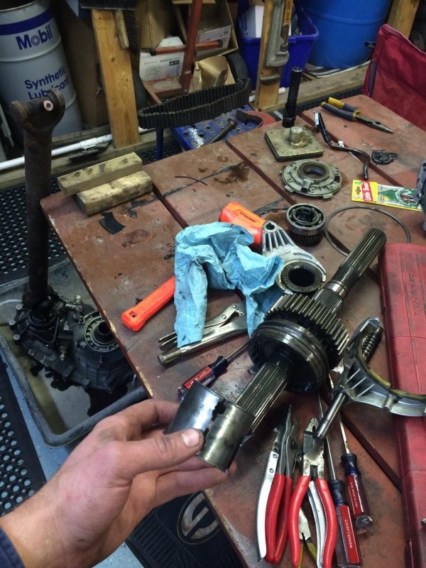

Ok, so i guess it didnt grenade but ive got noise @ 65-70 mph along with vibration. Checked out the t-case and found excessive play at the driveshaft at the output of the t-case, located hole in case and drained oil which had signs of metal. I wont have it apart to get the extent of damage until tomorrow afternoon but i am wondering if anyone has any suggestions for parts suppliers. I know for a fact ill need the updated rear case, pump plate and output bearing, just wondering if merchant is the way to go or???
