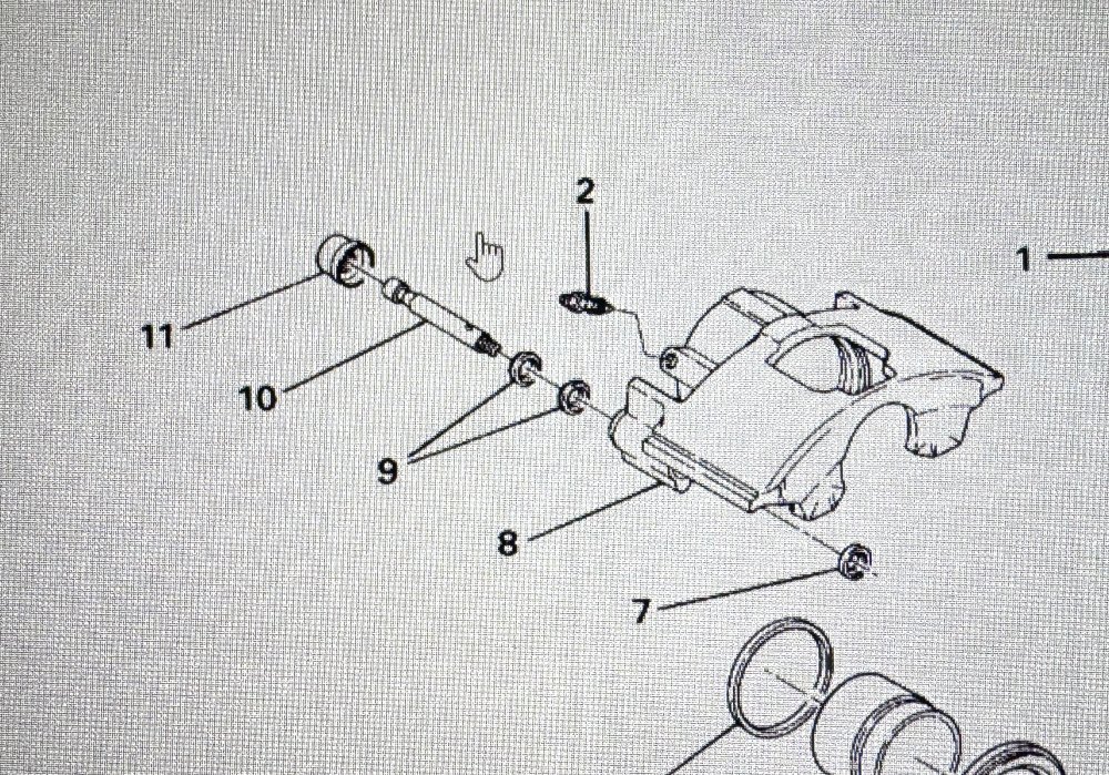

This picture shows a slightly different caliper as the bolts on the ones I had and the new ones have the bolt passing through a ‘guide sleeve’ (my term). The guide sleeve rides on the two bushings / o-rings (9) allowing the caliper to adjust to the brake pad wear. Or, maybe this drawing just shows the bolt and guide sleeves…I digress.

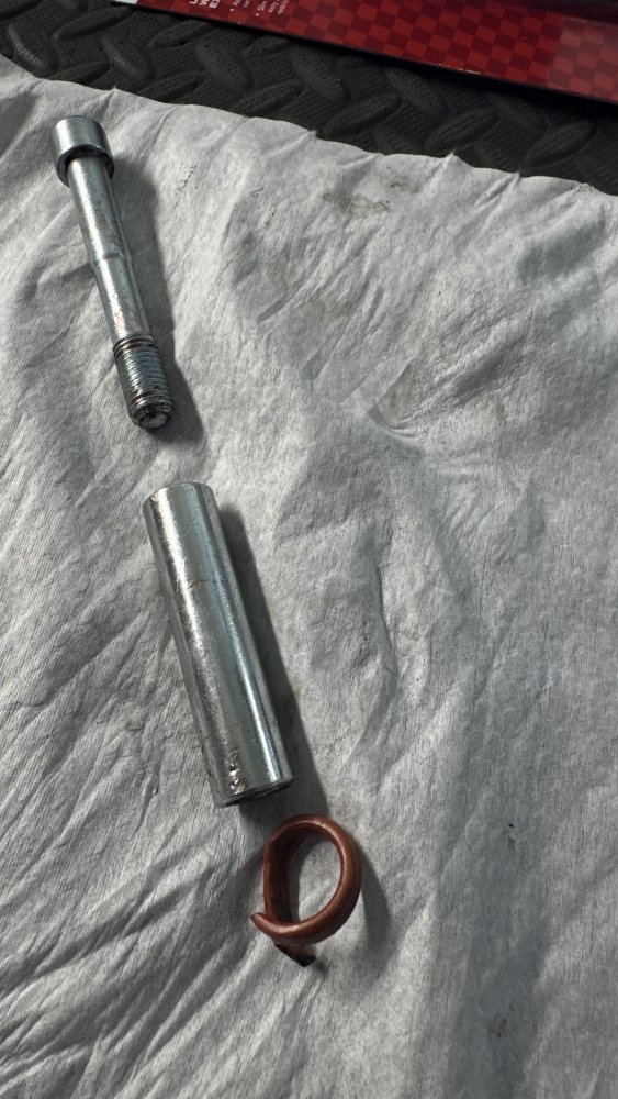

One of the guide sleeves had pushed inwards preventing the caliper from going back on so I slide it back and it still couldn’t get it back on. It was then I discovered that one of inner bushing/grommet (9) on the sleeve had been damaged, split and pushed out of the caliper from going back so, not going to work. Hard to explain so here’s the picture.
Yeah, I could try to stuff it in the caliper and attempt to reinsert the sleeve w/o driving it out of position and hope and all but, decided to replace the set. Since I bought them in October, it is too late to just return to Amazon for exchange. I’ll just box up the damaged one and return it after the new set arrives.

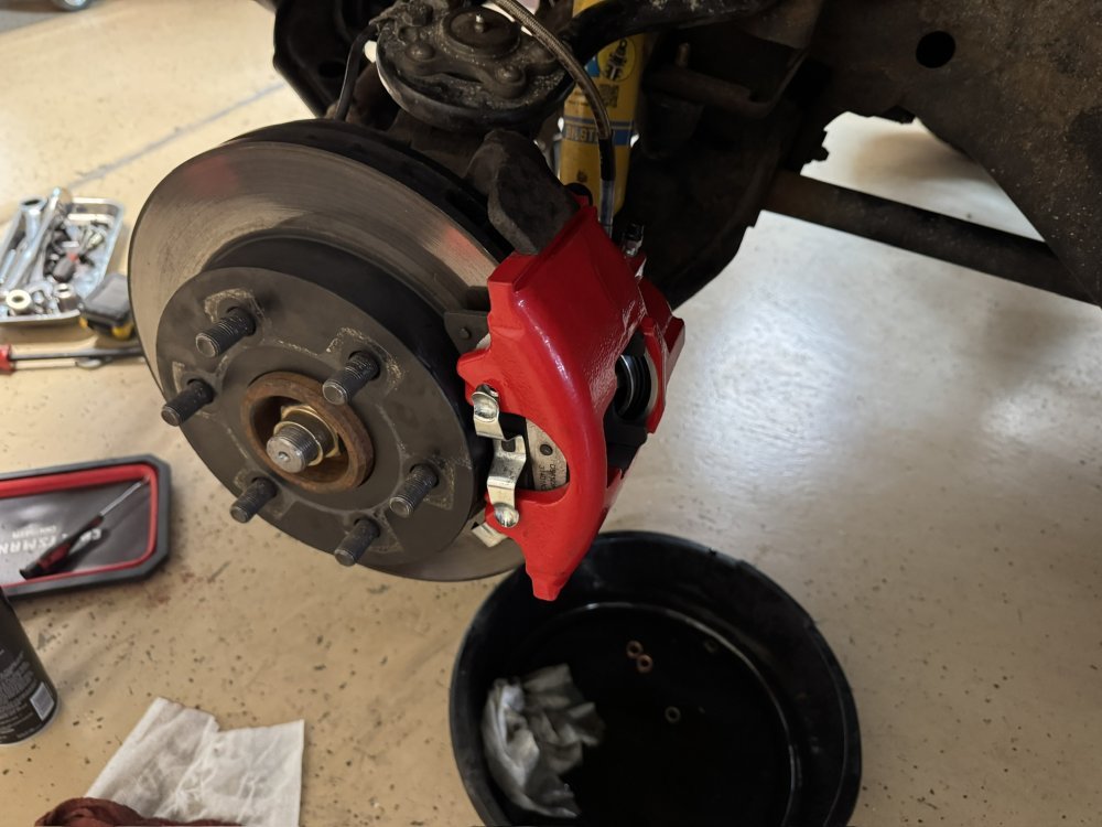

New calipers arrived. Install was pretty straight forward. Sprung for powder coated units so had to remove some off one edge to get the clearance for them to fit. Other wise, no issues.
Frau came out to work the brake pedal to complete bleeding process. Brake pedal is very firm now, even though it hasn't been driven. Previously it was pretty soft and concerning.
