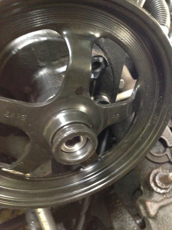

The spoked style pulley is nice for the reasons above, you don't have to pull the pulley in order to remove the pump. However, at least on my '95, the spoked style doesn't get seated fully flush with the pump shaft, so if upgrading to the spoke style make sure it's installed in the same plane as the rest of the serp belt system. Picture of where the pulley had to be for me to line up with everything else
