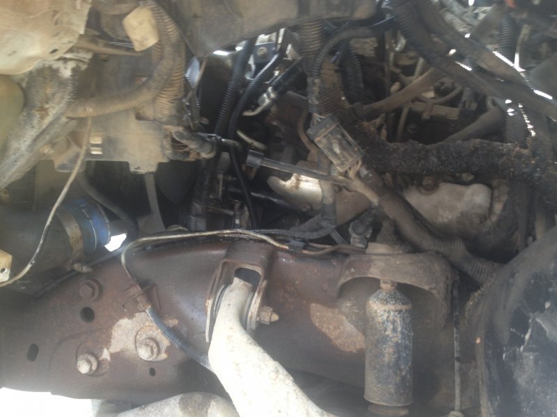

Hey all. My power steering line started leaking a bit a while back and now it's gone crazy! It's the line on the left side of the hydroboost that goes to the pump. Anyone ever replace theirs? I need to do this tomorrow and am looking for a tip or two to save time and hassle. I'm sure I'll figure it out, but tips are always usefull. Thanks!

Where is it leaking? There is an O-ring that seals or helps seal the line at the Hydro boost. Are you sure its not the weep hole underneath that is leaking? OR is it the joint of rubber to steel line?

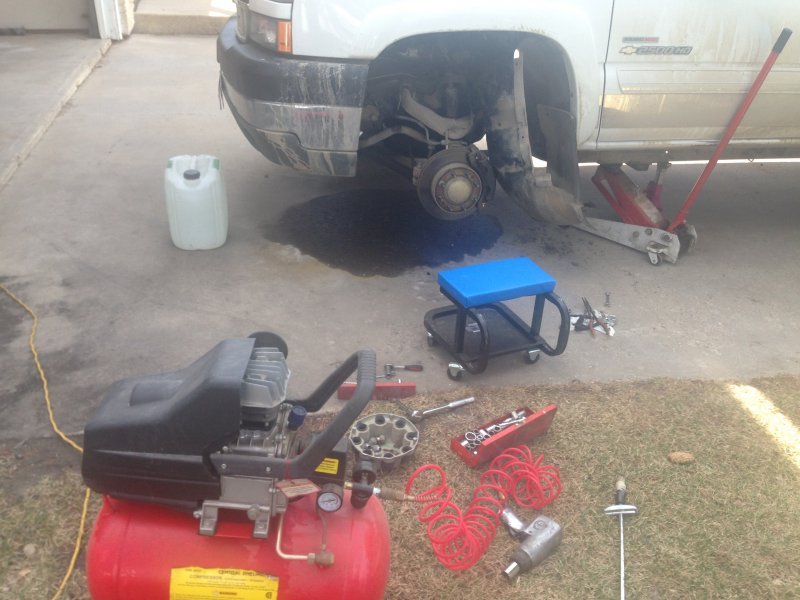

Job is done. Not as bad as I thought. I ran out of time as I wanted to wash the oil from the undercarriage. I'll do it later haha. Yeah the flush will be another day. I'm busy and need the truck all the time.
