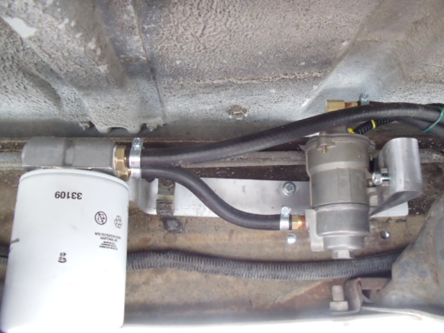

Raptor 100 on my truck. frame rail mounted, below driver seat. No issues with gelling even down to -35 C. Solid 12 PSI at all times and all throttle positions. I run a separate 30 micron pre-filter back by the rear wheel.
Didn't go with the Airdog "all in one" unit because I didn't like their (at the time) proprietary filter design.

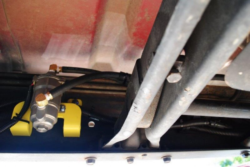

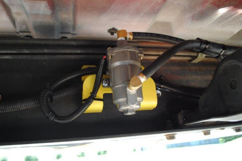

I may add a filter at a later date. For now, the tank sock still remains. After removing the factory style lift pump, I got about half a gallon or more of fuel out of the tank-side line that just siphoned off. I think if the sock was plugged, it would have broken suction. If I add a filter, I'll just make a new bracket using the same mount holes in the frame. These four holes were there from the factory, so I had no drilling for this bracket installation.
I went to put on the bracket, but hadn't painted it yet. The only paint I had sitting around was this bright yellow. I guess it will, at least, not rust and it's easy to find.:shame:
I had to lengthen the wire by a couple feet due to the location. I mounted it behind the torsion bar mount so it would be shielded from heavy slush or road debris (although I don't do much in the salt belt, here in Ohio)

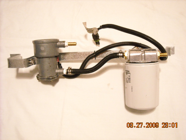

For what it's worth, these are FRB-5 photos but the principle is the same.
Picture I purloined from Leroy's old web page.
