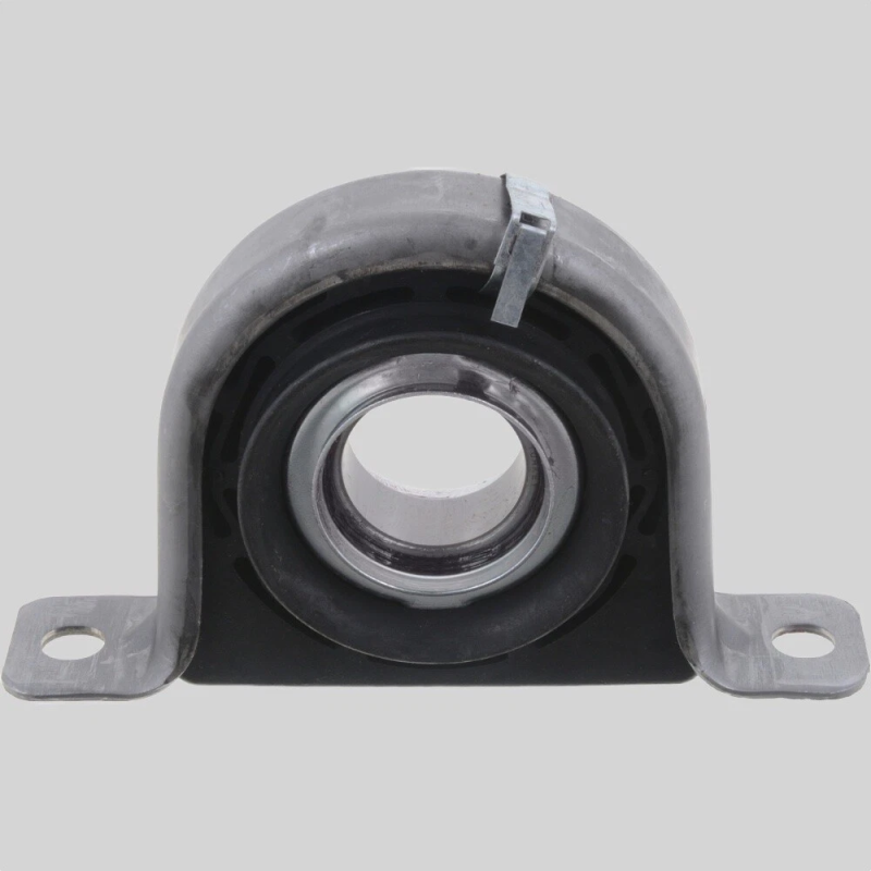

Forgot to mention this earlier......the carrier bearing has a little steel strap on it, like in the pic here. It is broken....not sure what it does. Is that a big deal?
I believe that steel strap is mainly to hold the rubber insulator within the steel saddle affair during transport before installation.
