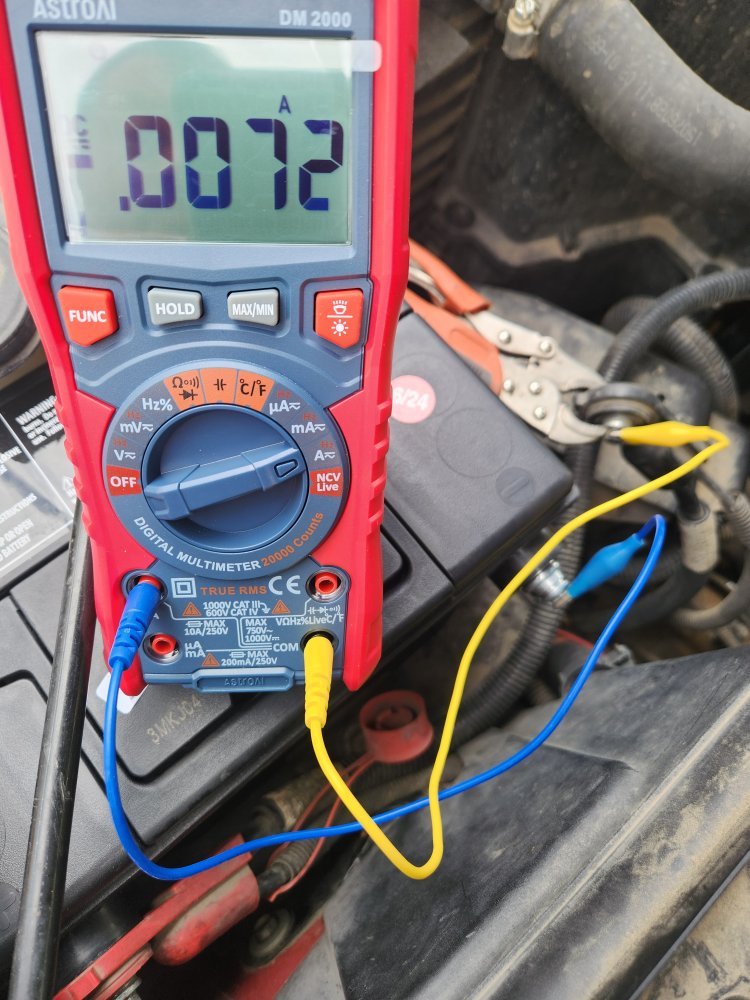

I'll definitely do a parasitic draw diag as soon as I have the correct tools. the only multimeter I have left that's halfway decent can't measure amps. the only test I can do until then is measure voltage drop across the fuses. not the best way to test, but a large power consumption should be detected, which I don't see across any of the fuses under the hood or inside. that is why I was starting to wonder if it's the alternator, since I can't currently test it with what I have other than voltage output when running. that test says it's putting out around 14.7 volts regardless of what kind of load I introduce.
once my new and improved multimeter and amp clamp get here I'll be in better shape to diagnose.
