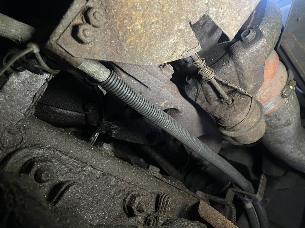

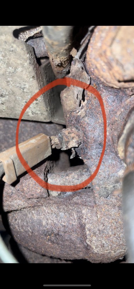

Bought the above described RV. Friend of mine told me to join this forum. A lot of mechanics decline working on these and I’m looking to learn to work on it myself. Shuts off while idling every few minutes. But after buggin for an hour it can take me across the country. My next move is to replace the glow plugs, never done that, they’re rusty, and my turbo waste gate is stuck open. I’m patiently working on it to get it starting normally for good. Gonna look around seek help and ask questions. The photos are a glow plug and a waste gate tied open by the previous owner.

Might give it a good pressure washing to clean it up then start spraying penetrating lube on glows and the w/g arm. Expect to find the turbo needs a rebuild. Get a removal tool for the glows, your gonna need one, look into a better glow plug harness also.

Welcome @Vlad_p01 That is a nice looking RV you have there. PB Blaster or some other penetrate oil and heat will be your best friend along with lots of patience for the glows. looks like lots of rust on them, the heads might be far too gone for a normal socket to get a bite. as Chris said, get you a puller too.
worst case scenario will be pulling the heads for a machine shop to remove them and any other broken bolts on the manifolds during the process.
Welcome.
As mentioned, pressure wash and wd40 the glow plugs, plan on heat.
It might be the death of the head- rust wins sometimes and that doesn’t look friendly to me. Unscrew them and if it slides out just like removing a spark plug, great. If you unscrew it and it won’t slide out, stop. Screw it back in and order the glow plug remover tool from Leroy.
Don’t put a penny into the gm turbo. A bigger turbo like an hx40 will pay for itself in the fuel savings. It helps some on pickups but a lot in an rv. It’s easier on the engine and as a bonus it will accelerate a little better.

One last thought. Stick with OE spec glow plugs (GP) and DO NOT fall for the hype of the extra hot things. The OE spec GP is able to handle the alternator applying 14.X volts after engine start, the extra hot things can only handle nominal voltage (12.X volt range) and will self-destruct within the first 10K miles unless able to prevent the alternator from supplying current while the GPs are active.

It did overheat while towing and going up hill while I was driving through the Rockies. Turned my heater on to help, and trying to take advantage of going downhill or flat, it would cool down then. The fan indeed doesnt spin. Its locked in place. Decceleration is poor indeed, I thought it was only brake related but I see there is also a transmission aspect to it. Will attack the glow plugs first. I'm looking at how rusty they are and following the harness.. which goes into another harness. Lol. I'm taking notes and getting all my questions ready and will ask the forum soon.

Thanks for the info Will! Looking at the glow plugs now and collecting information on how to replace them properly. Thanks for the details. Will post my questions soon on the forum. Maybe a defective turbo is why I get poor acceleration or stuggle at 30mph uphill. Yes I've had overheating going on I turn on my heater to help the heat discipate (I guess).
