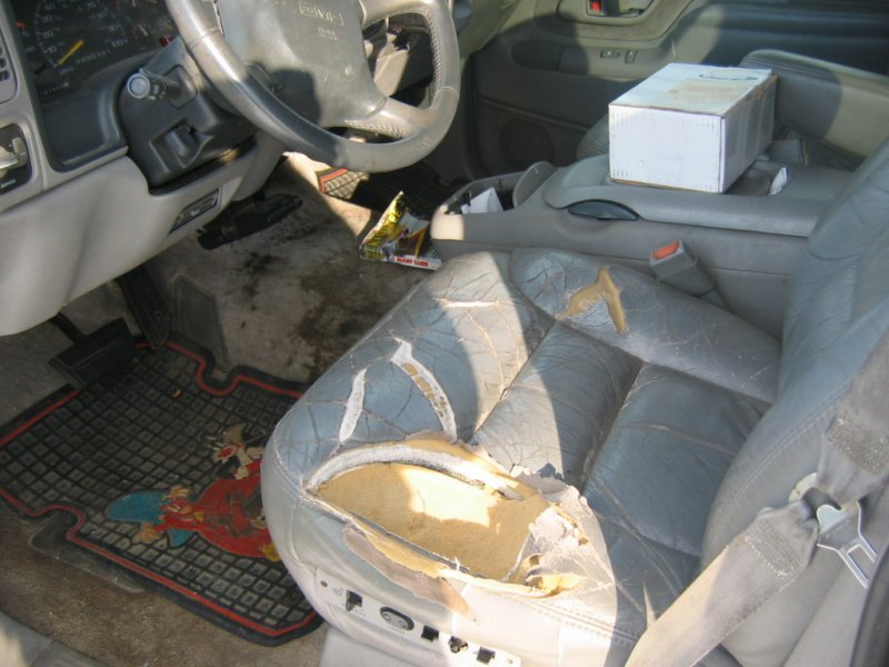

Leather seats - the front seats need to be replaced.
Custom coffee/diet coke stains on the front floor - It needs a good detailing
