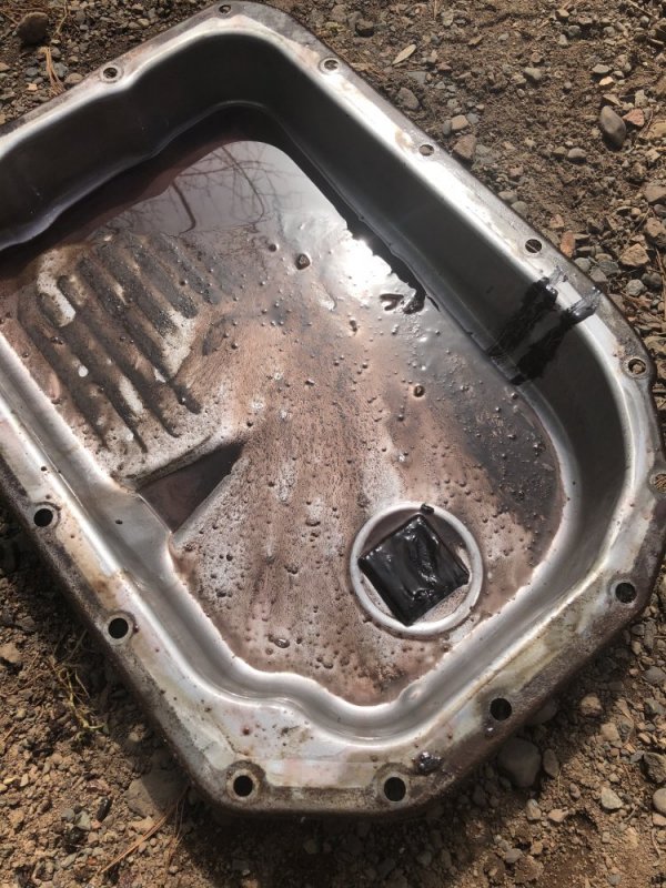

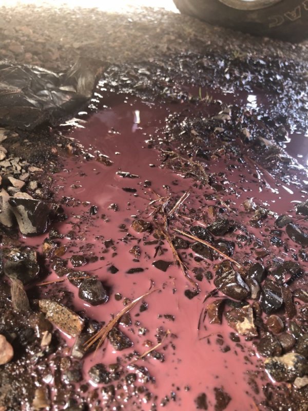

Welp........ I think I found the issue. Internal harness connection was broken so i dropped the pan to replace it. Pan came off and out spilled strawberry milkshake so somehow either coolant or water has gotten in with the trans fluid. (Kinda odd since the fluid looked bright red on the dipstick a week ago)
anyways here’s some pictures of what was inside. So now I guess the question is what’s the most likely place this coolant or water is being introduced at radiator, trans cooler, pan gasket? I hate to put another trans in only to have this happen again

Do you have a tranny temp gauge? That looks like either (a) you boiled the hell out of it..or (b) did you add fluid recently and possibly put wrong kind in? Like regular dex/Merc than accidentally added synthetic?...just ideas. I'm not tranny expert. But that I know of coolant don't go in tranny.. tranny fluid goes up to tranny cooler to cool it off then back to tranny..but I could be wrong.
