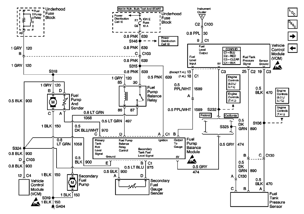

!998 cab and chassis dually small block VORTEc automatic, has no pwer to the fuel pump relay. Truck quit while driving and a crank position sensor fixed it initially then it happened again. Replaced CPS again and do not get any power to the fuel relay block. A shop towed the truck in and replaced the forward fuel pump which I had replaced 3 months prior and still would not start. They ran a hot wire from the tailights and twisted all the pump wires together and the truck runs. Attempting to restore back to factory and now will not run. fUEL GAUGE IS PEGGED HIGH AND HAS NOT BEEN WORKING WITH THEIR FIX, HAD TO TURN ON THE LIGHTS TO START. cOST ME $1000. I need help finding out why the ignition system is not getting power, the pump runs. Its a mess and I am not an electrician much.

You are going to need a wire schematic to sort this out and put it all back together as it should be.
IIRC there is two fuses that might be marked ECM1 and another ECM2. Either one of those could be supplying power to the FP relay.

There is no power to the relay pins. I can not find a diagram that shows where the power comes from. The garage connected all the pump wires to my tailight power and had to turn on the lights to start. I did all suggested cheks and have nothing. Only powered the front pump. Replaced all parts, Relays, balance module etc.
Here is links to service manuals for your rig. this might help you with diagrams.
