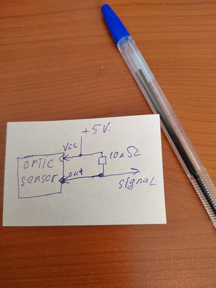

To open the FSD, I used a signal from a low-resolution optical sensor. The sensor output is of the open collector type, it needs to be pulled up through a 10kOhm resistor to +5 V.
I’m not sure what that would be.
I did a search fir open collector optic sensor and got lots of stuff I dont understand.

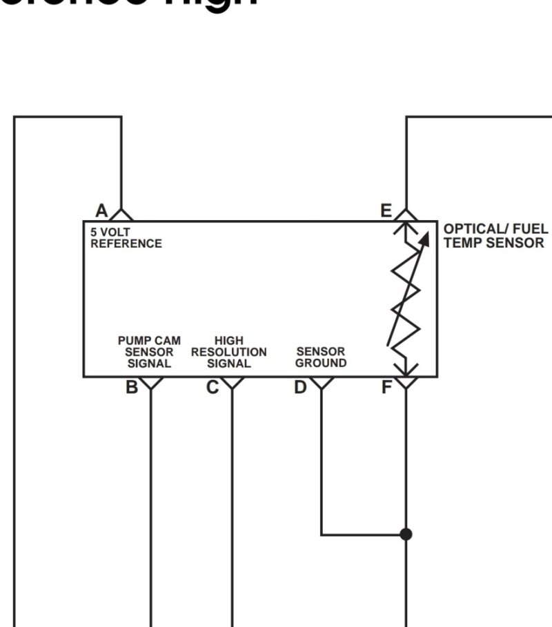

The pump has two built-in optical sensors, low resolution and high resolution. No external sensors need to be connected. The one built into the pump is used. An open collector is a type of electrical output where the presence of a signal is a low voltage, and the absence of a signal is a high voltage.
