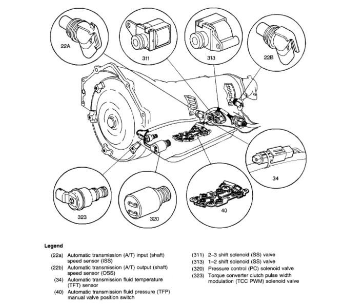

I just did a quick search on your DTC code. check all your grounds. remove them and clean the connections well, then clear the codes and re-check. I attached a bit of text that I copied from a site online for troubleshooting that code and a photo of the trans shift solenoids. I hope this helps. but do clean the grounds, that could be the source of the problem. their may be more ground connections on or around the transmission and the bell housing. you may need to remove the dog house to get to them.
