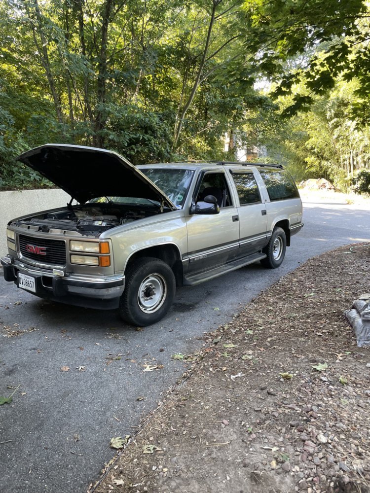

Interesting followup, this "Burban" was purchased new for $43K driven until June 2014. At this time, had 139K miles, or so. Was parked with a full tank (42 gals.) and sat until August of 2022. At lot of life happened. One day, in August of '22, I woke up and decided to get the old girl running again. Bought two new batteries, held my breath, turned the key when the light went out, she fired , rattled and grumbled a bit, then, settled int a normal idle. I thought WOW! Ok, I put my foot on the brake pedal shifted into gear and realized "NO BRAKES" Yikes!
Well, after replacing the MC, and all of the brake lines from the ABS backwards, both wheel cylinders, both caliper units, ( & Pads), bleeding the system a couple times, she rolled out of the driveway and off we went for the next 5-6K miles, then the trans started not shifting. After diddling with the 4L80e on my own and not getting any improvement, I had the tranny rebuilt.
To my amazement, the body has no rust, except what's on the frame and this is mostly surface stuff. The interior is in very good condition , all of the gauges work, except for the AC. I have since relocated the PMD to the inner bumper area, replaced the lift pump, replaced both oil lines with lined braided SS units, the oil cooler, added a transmission cooler, replaced the RAD with an aluminum, the damper, belt pulley, replaced the block heater (600W), and a couple of sensors. Removed the Intake coverer for better cooling. Oh, replaced tires with HD units. As of this entry, has approximately 146K miles. What's still amazing to me is that tank of diesel ran through the engine with nary a whimper after sitting idle for "8 years"?
