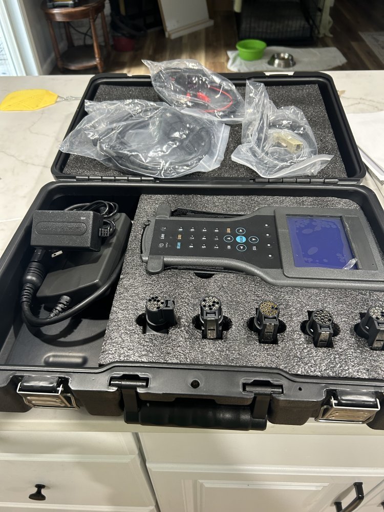

Excited to get my new scanner. You think for that price it would have a users manual included. I guess that’s extra. Anybody ever buy one of these? I guess I’ll go hunting on the web.IMG_0895.jpeg
You might lookup the manual for the real tech 2 and see how much of it is the same as you roll through each function. test it out on a known working vehicle other than your diesel first. then move to the diesel truck.

Thanks guys, I figured it would take a while to get use to it. I did find 2 manuals online one for the genuine gm tech2 and one for the CKO tech2 it’s slightly different. Yes I’ll use it on a different vehicle to get use to it. The only car I have is a 2002 Mazda. It has a OBD 2 system on it. I’ll see if I can use it. Also thanks for tip on not bending the pins on the cable connections.
I just got an e mail from the eBay seller of the CKO tech 2 and he said the 2 CD,s that should of been with the scanner when I received it is coming in a second shipment. I did download the user manual for that scanner and went thru the power off self test and it failed, says to call customer support. They will probably tell me to return it to the seller. It also failed the key pad test and it said 1 of the adapters was not hooked up and it was. Did an ohm test on that adaptor and it is bad. I don’t know if those CD,s are going to tell me any more info. than the user manual I downloaded. Now I am going to have the seller see if he can send a new adaptor. And I still have to call customer support. There is no contact info. in the user manual for the customer support line. I may just Fxxxing return it and purchase the GM scan tech and a laptop. What a PITA!! Thanks for listening.
