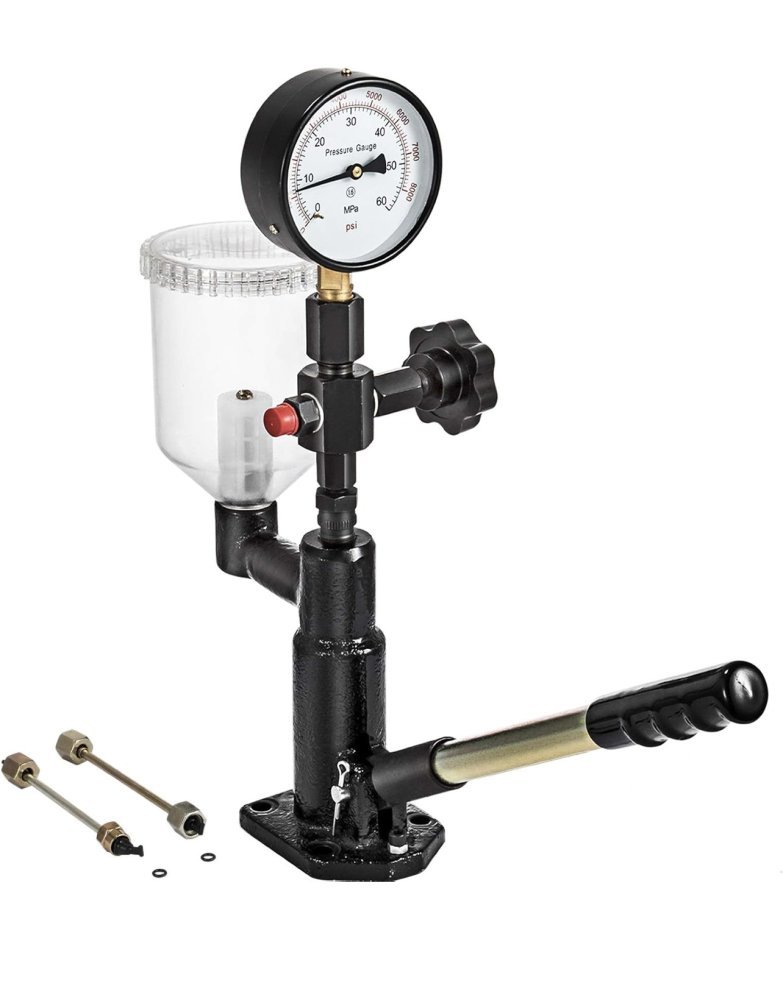

Get the pressures set to within 25psi of each other. Ask for knowing what the starting pressures was.
That pays for itself in mpg. The improved power is just a bonus.

Whatever You do, have them tested before installing them.
