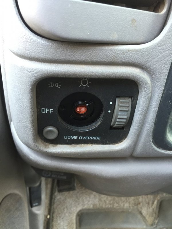

Banged the switch with my knee while hopping in and broke it off. This is in my 1999 Suburban. How do you remove and install the switch?

Pull the dash bezel then remove wires from headlight switch then remove switch. Just be careful of the plastic tabs which break really easily.
The trim piece surrounding the gauges over to the radio. It just snaps in place, the gear shift has to be in 1st and the steering wheel lowered.
Dash bezel has some metal spring type clips comes off pretty easy. The wiring clip comes off pretty easy too the actual switch is the hardest part to get out mostly because your trying not to break the plastic tabs that hold it in.
Are the tabs on the bezel or the switch itself?
The new switch arrived and I had it installed in less than 10 minutes. It was as posts here described. Shifter in 1st gear. Steering wheel pushed all the way down and then pry off the bezel. Clip holding switch extend from the bezel. Gently pry those up on one side, then the next. Wire harness plug has a clip tab that needs to be pushed in as you're pulling it off. Put it back together and as you're pushing the bezel back in, lead with bottom edge and gain some extra clearance for the gauge panel frame by pulling the steering column lever and pushing the column down for that extra bit of range and the bezel goes in.
