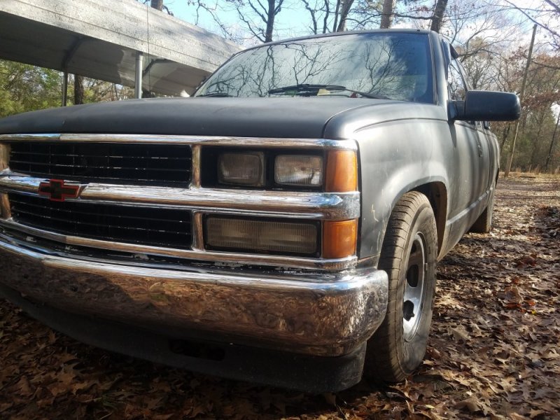

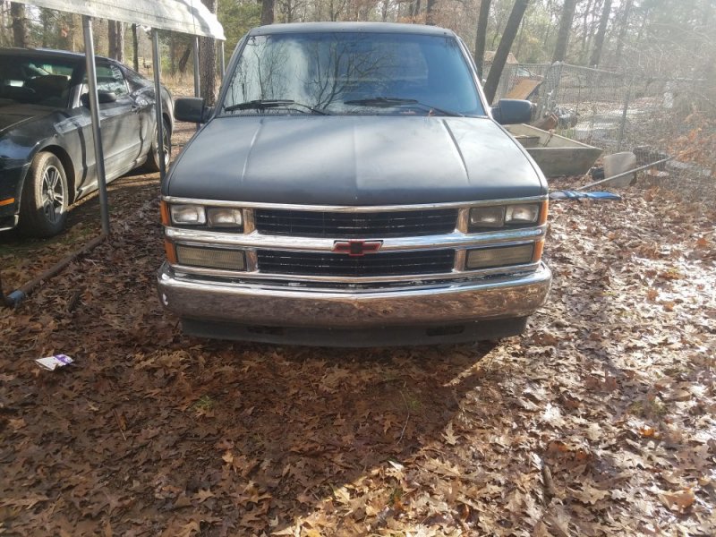

Hi, this is my first post here and this is my main reason for joining this site. I bought this truck with the grill/headlights it has now, I dont know much about chevy trucks but i do know that my 93 chevy has a non stock front grill with headlights from a different year truck the 4 sealed headlights instead of replacable bulbs.. which do look great but will look much better when i can figure out the year of my grill so i can order new lenses/covers for my marker lights. ill include a couple pics and hopefully someone knowledgeable about these gmt400 trucks will know the years i should be searching while looking for compatible parts.20200118_102933.jpg
88-89 sealed beam headlight assemblies (LMC has replacement lenses that accomodate drop-in bulbs). All GMT-400 core supports are the same in light duty, the work truck 5x7 bucket plops in or 4 bolts are used to bolt the composite or dual sealed beam assembly on, such as you have. All of the grilles have the step in them for the staggered light arrangement as you see. That grille specifically would've required minor trimming on the backside to fit over the 88-89 assemblies. GMC grilles do not require trimming.
Grille is 1994+. The grille, lower filler, and inner bumper brackets all need to change for that to work. If your bumper is squishing your filler panel then you'll need inner brackets. 88-93 front the bumper is 1" or so closer to grille than 94+.
