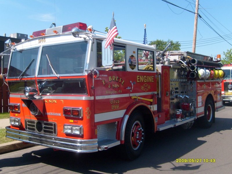

hi i'm from Northeastern PA , i have /own 3 fire engines my 1966 can't go on road again until i get 10.00x20 tires for it, one front steer for now but if price right i'd be interested in 4 other rears for it, i had bud rim fail & insurance replaced 1 tire [email protected], i fear after all time.money,sweat,blood my son & I put into rig it will sit another year or it gets scrapped
Go with common 22.5 wheels and tires using that standard 10 bolt big truck pattern.. (?)
There are options for rolling stock. No need to shelf a beautiful machine or three..
I was thinking this, too. We run some pretty low profile tires on our 22.5 rims on our machines. The OD is around 36.6" if I recall correctly.

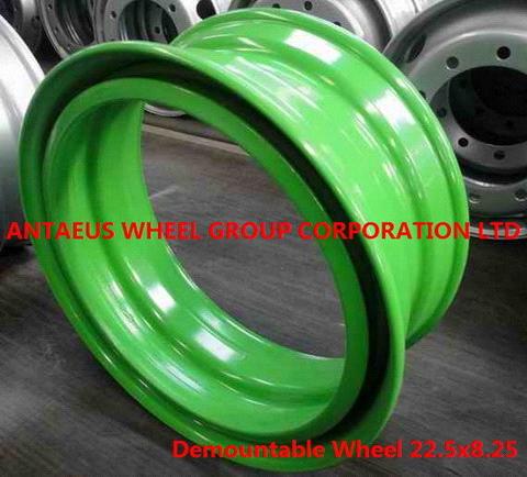

Additionally, if the truck has Dayton wheels hiding behind those covers:
Go with demountable 22.5 x 8.25 wheels and tubeless radial tires of either 11r 22.5 or 295/75r/22.5 size.
22.5 demountable fits the 20" Dayton hub and 24.5 demountable fits the 22" Dayton hub.
You'll probably need longer wedges for the drive axle in the changeover. Some steer hubs have 5/8" studs. Most drives are 3/4" and easy to tell steer and drive wedges apart.
22.5 radial tubeless demountable wheel:

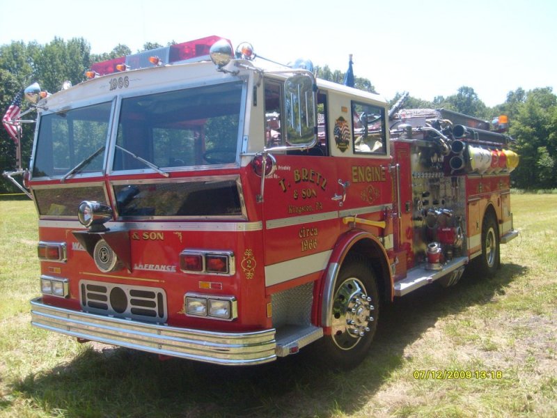

gee by some replies sorry for asking but to others thank you now where in pennsylvania do i start??????? i tried local scrap yards first with no luck, my rigs are fully loaded but only no more than 300 miles a year only shows & parades any help or guidence appreciated, these started out as father/son projects but his wife & mom now want them & me out of his life so i'm all alone on these endeavors, being handicapped by 2 strokes myself makes it even more difficult, thank you in advance
look on vintage truck marketplace on facebook.
I also second the idea of swapping rims to the 22.5 tubeless.
8.25x20 and 9.00x20 are hard to find, 10.00x20 is still relatively easy in comparison.
That fire truck looks like it has plenty of front axle weight, you might look into a 12R22.5 on the thicker centered wheels.
