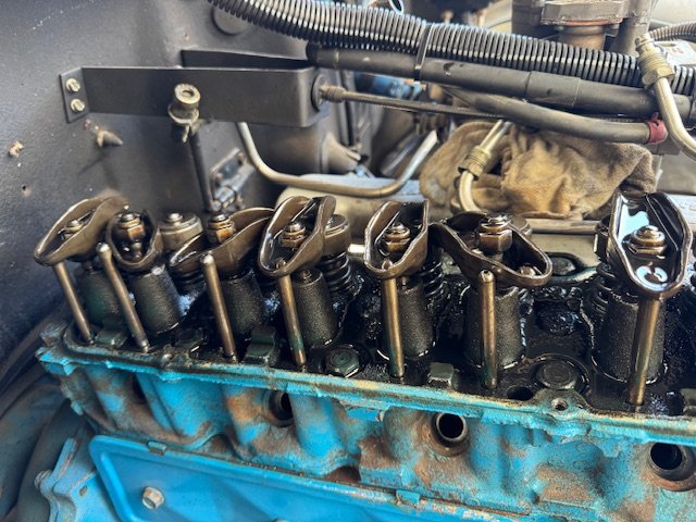

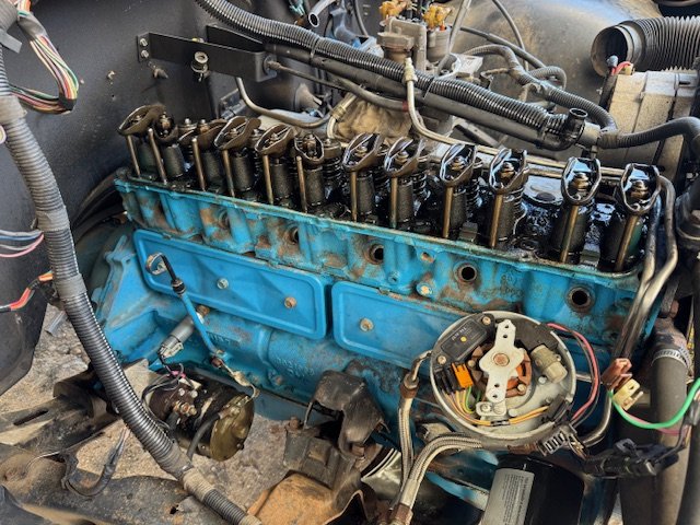

Now I'm getting concerned and thinking bad rings and a blown piston or burnt valve. I wanted to have a look at the cylinders but could not find my bore camera anywhere so I pulled the valve cover to see if something was up under there...

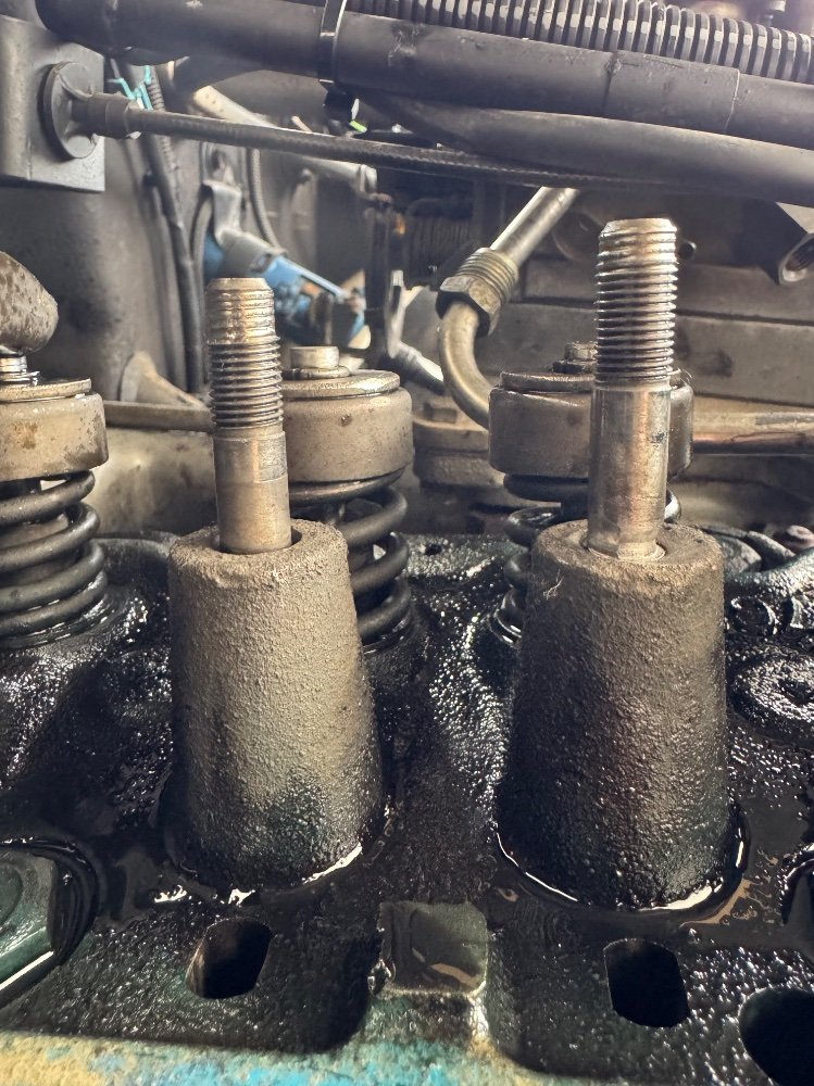

do yall see anything wrong with these photos?
Yes this thing has been running on three cylinders for a while from the looks of the plugs. funny thing is it doesn't miss and runs smooth even trying to goose the throttle while sitting still.

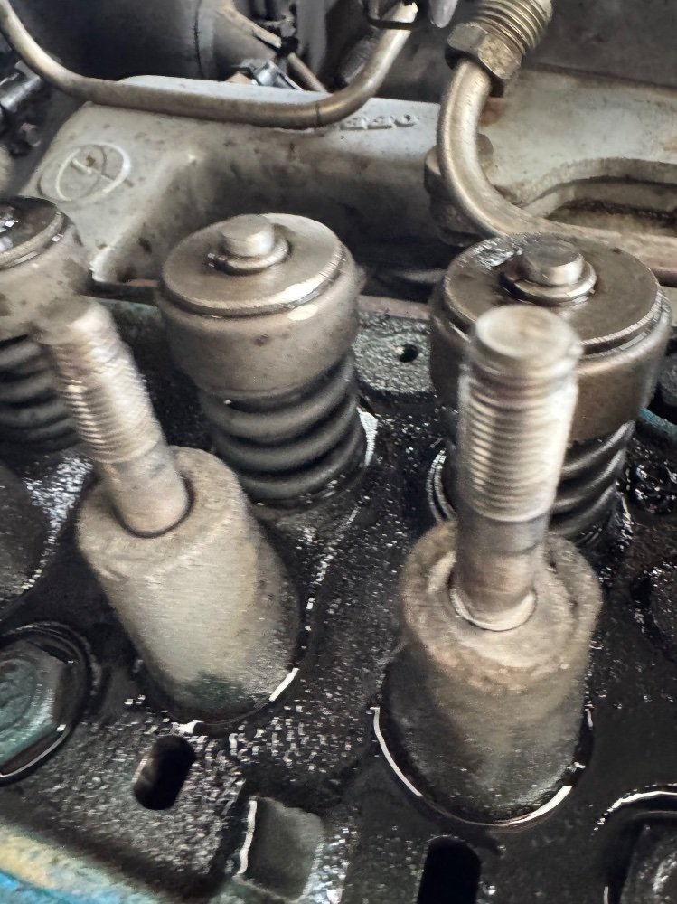

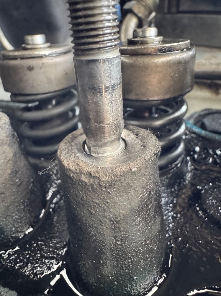

from what I can tell, three of the studs on the head holding the rockers have pulled up, I can easily see the three studs are higher than the others.
I really hope there is a fix for this without having to pull the head. the push rods on these three are also very slightly bent. wiping them off and rolling them on a flat surface I can see a slight bend, also the push rod on #4 has a indentation on the ball end where it was slapped a time or two. hope a valve is not also bent, this cylinder had no compression at all.
you guys know if there is a repair for the studs pulling out of the head? I assume a thread repair kit would be needed not unless there is a longer stud and maybe some extra threads further in the hole that can be used. IDK. both my son and I are bummed to find this.
Just reading online trying to find a repair, I am finding out that the studs may not be threaded into the head. I always thought they were threads in there. I can't specifically find that info on a 250 L6 engine though.

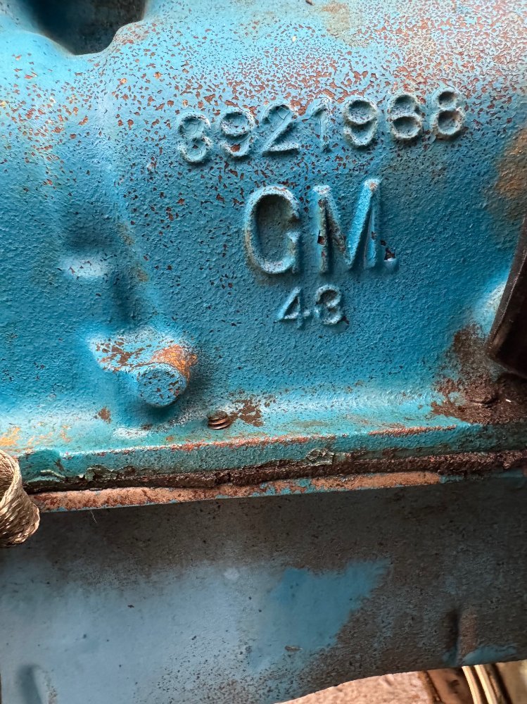

Trying to ID the block and came up with this.. block casting number is 3921968 date code is H157, other code is CON2
From what I found the casting number can be a GM 250 or 230,
Date code H157 shows the 8th month, 15th day, 7th year of the decade. Meaning August, 15th 1967
Code CON2 is conveyor #2 in the GM plant
I cant see the vin code stamp that should be on the dist boss, doesn't look like anything is stamped there so I cannot verify if this is the original engine to this truck.
Rockauto shows press-in rocker studs for this engine. both standard and oversize. Not sure if this is a repair that can be done on the truck or even on the bench. may have to be done at a machine shop. I saw where the studs can be pulled with a nut and stack of flat washers and might be able to be re-installed by freezing the new stud and heating the boss on the head, but not all that sure it would hold.
I would check and see if they're the same studs as a sbc. If so you could get screw in studs for it. It would be better to do the threading with the head off but probably could be done with the head on if you're really careful. I wouldn't try replacing with press in, those holes are probably messed up. Most of the stud failures happen with stronger valve springs and higher lift cams. If you really wanted to cheap out you could hammer them back in then drill and pin them.
I had been looking at the pinning process. from what others are showing online, they are different than the SBC studs, but I've never messed with rocker studs before. as far as drilling and pinning with an 1/8" roll pin, I can access the bosses on the head. Just not sure I want to try.
I have a gut feeling that #4 piston kissed that valve, the head would have to be removed for that part. I can pull the head without pulling the intake or exhaust manifolds and replace the valve if needed.
also it's on my mind wondering now that three studs are like this, what's to come of the rest. and what may have caused this. we don't know if this just happened or it's been like this for a while. when the ignition module started acting out it did pop and spit from the intake a few times, I wonder if the backfiring might have done this as well. looking at the plugs, it's been like this for some amount of time, but then again we did drive this truck out on the freeway for about a 100 mile round trip last month. I doubt it would have had any power nor would have made that trip in this condition then.

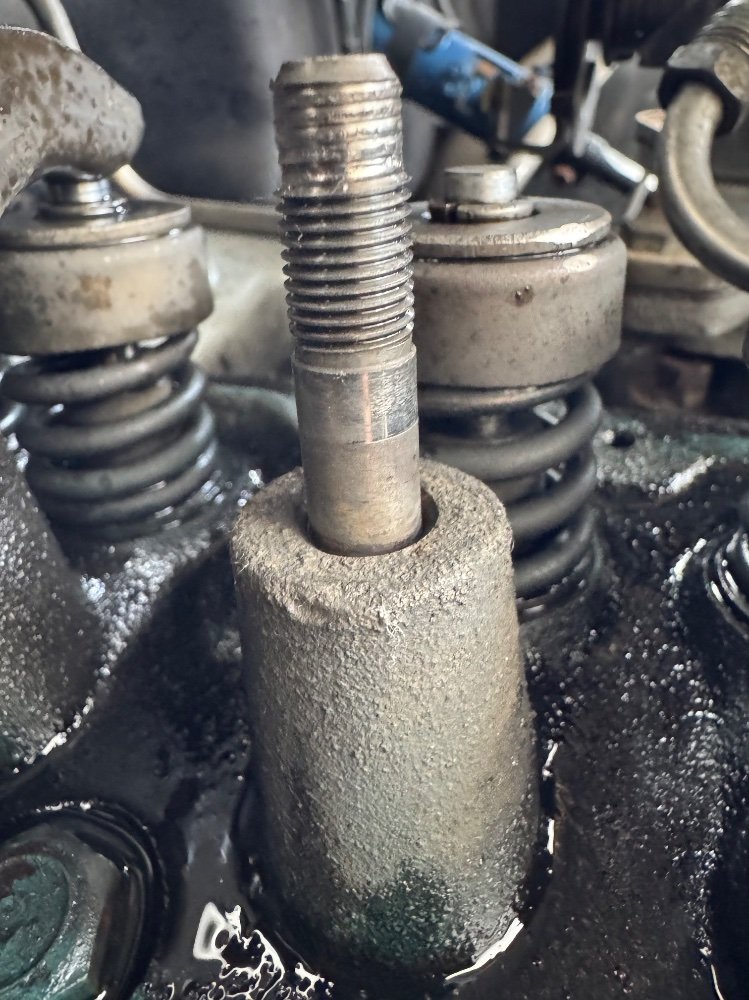

I pulled the rockers off from the #4 cylinder to have a better look and this is what I found. This looks like it’s been this way for a long while. The base of the intake valve rocker stud has wear and so does the top of the boss where the rocker sat rattling around. There is also marks on the exhaust valve spring cage where the intake rocker was striking it. The threads on both studs don’t look great ethere. The exhaust valve studs was just fine, hadn’t pulled up. I just pulled the rocker to get a better look
Measured the studs. they are in fact 3/8" studs that stick out from the head 1-11/32" from the top of the boss. thread height is 3/4"
these are the measurements I got with my caliper: 0.372" diameter and the base, 1.342" height from the boss (good stud), and 0.753" thread height
I need to gather this info on SBC threaded studs to see if that is an option, but it's looking more and more like this head will need to come off, be stripped down and sent to a machine shop to have them all replaced.

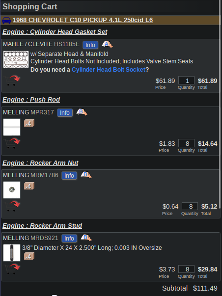

Here is my RA shopping list so far. I don't see head bolts listed or replacement valves. Not sure if these head bolts are reusable or have to be replaced. I have a good feeling I will need to replace the intake valve on #4 but the head will need to come off to check for damage unless I find my bore camera to have a look at the piston top.
