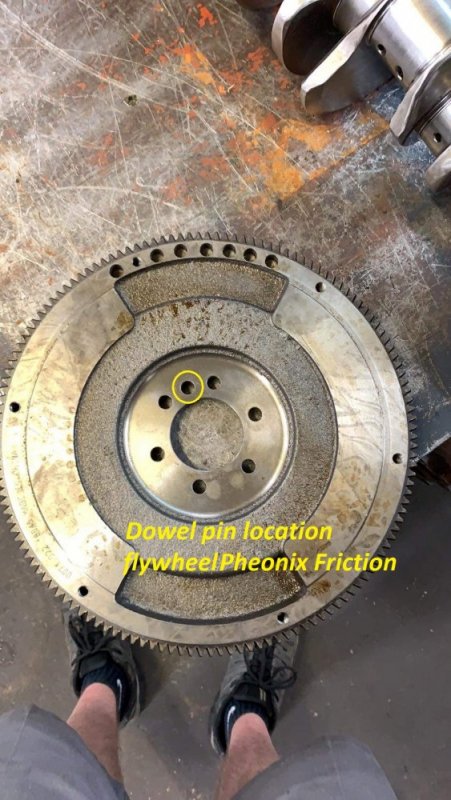

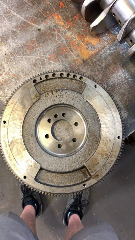

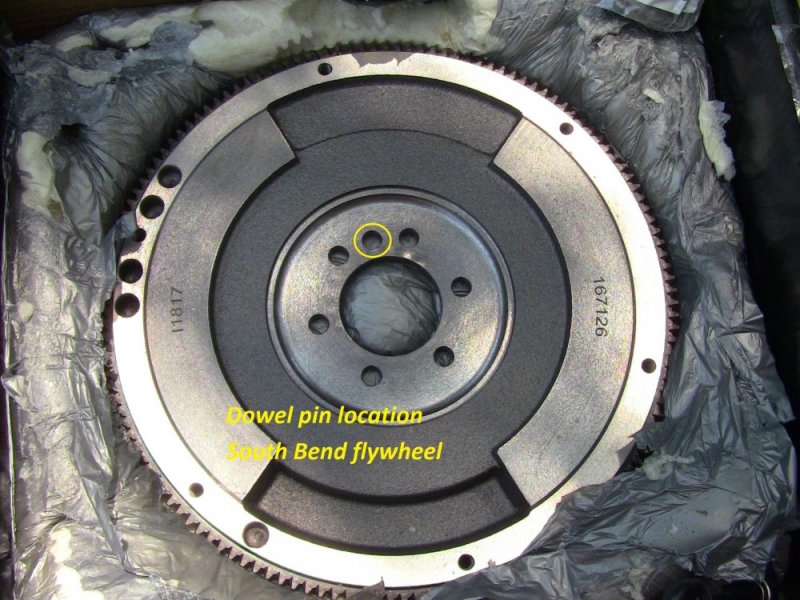

A pic of the back of the Phoenix Friction flywheel... If others have a old flywheel around post a pic of the back side for comparison, my south Bend kit will be here next week, I'll post pics of it as well..
The series of holes is where it would need 90 grams / 3.2 oz added to be good.

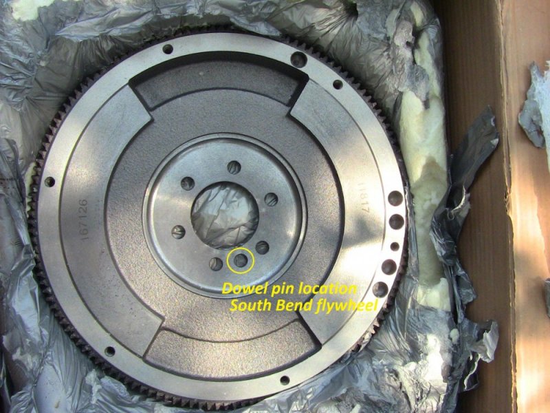

Pics to show location of the crank dowel pin between Phoenix Friction & SouthBend ....
The dowel pin location makes all the difference where the balance really is....

Looks like if you rotated it 180* the dowel pin hole is in basically the same position relative to the casting. Not so much on the drill holes
Yea, one pic may be upside down, the phoenix unit is gone now, I can't really tell if the dowel is on the shallow dropped area or not on that one, would be good to see a old stock unit...
