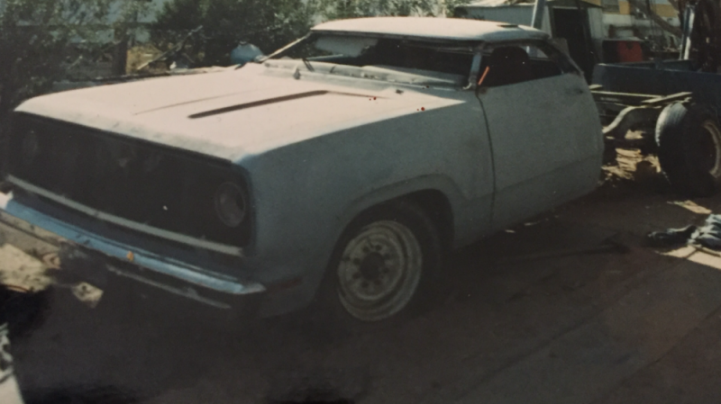

WarWagon, I texted the wife and asked if she knew where pics were of my old race truck. She said "this one?" Omg race not hot rod low rider build. She's going to look around for it. I ruined a lot of things along the way...thought you all could laugh at this before we channeled the body and 6 point hydraulics later...
Poor dodge. Forgot I owned that. Recovered memory therapy NVW? I think I was 14 at the time.
I sure hope you weren't any older than that.:rolleyes:
In my defense channeling 8" out of the body made the 12" chop top match, and that was after tacking in place, no where near finished. Oxy/acet torch and clothes hanger welding was quite the lesson. Not enough bondo in the world. My dad just laughed and shook his head. The bed did a 45* rearward raise 6' off the ground and spun in a circle, or could dump, based on valve position. Butterfly opening snug top shell. I was overtaken by low rider trucks when they came out and was still influenced by 50's lead sleds.
Told you guys I'm an idiot sometimes. The rest of the time I sleep.
