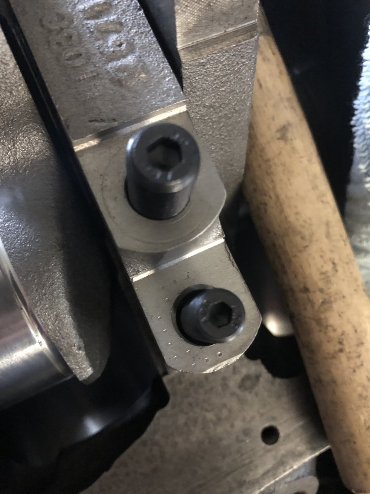

So my 506 block has the two different size holes for the main studs, but my caps have same size larger holes. Are these the wrong caps for this block?

See post #8, apparently GM couldn't be bothered to change the caps to match stud size

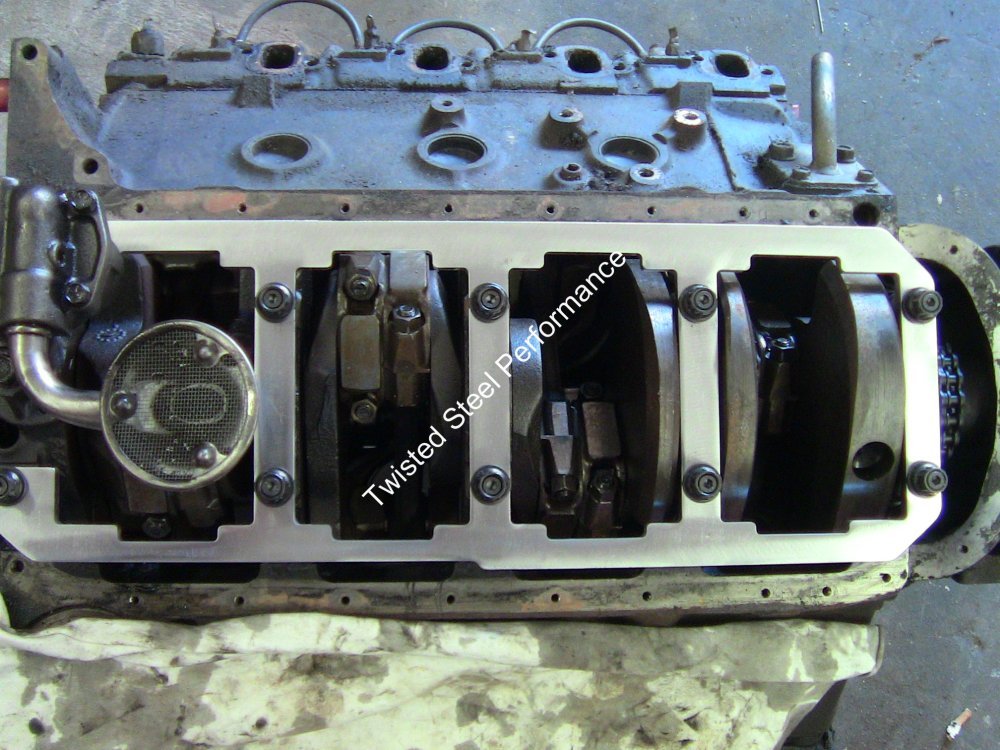

Yup- get the halo girdle imo. Adding sleeves wont help- if you were to weld them up and drill out then reharden the caps and then alingn hone- ok. But the gaps of sleeve inside caps- I don’t think will do much floating around in there
With a large hole and small fastener, it tells me the only thing the outer bolts do on later blocks is hold due to friction between block and cap - not a mechanical stop. That said, the block and cap can still move independent of one another in this setup. In terms of bolt tension, I suppose an argument could be made of the benefit, but for lateral stability, the outer bolts do little in their current setup from what I can tell. A better design (and I'm no engine block designer) would be a shoulder bolt with the shoulder about the same length as the cap hole. Assuming the shoulder was a machined fit to the cap, the outer bolt would see shear and tension, but no bending to speak of. The bending wouldn't be as likely to be transferred into the web.
Put the originally designed studs in place, throwing away the bolt idea totally, and I think a guy would have a superior setup in a factory style configuration if they didn't opt for splayed mains. I'm further convinced that bolts do not belong on the main caps - only studs.
The larger bolt still fits sloppy. The head of the bolt pushing the cap against the block is the holding force.
The cap is already an interference fit with the block- that why a rubber mallet is used to tap the cap in and tap it out when the bolts aren’t even there yet.
You don’t want ANY friction between the bolt edges and the cap holes because that is force loss that otherwise should be transferred to clamping force.
The only time this would be a problem is IF the head of the 10mm bolt was to wear away and go into the hole. But the torque is no where near enough to distort the foange of the bolt head, or the washer if you use studs.
If you were to try having the holes fit the bolt so tight they could stop cap walk, the threaded holes in the block would have to be drilled and tapped to within 0.01 location. Because if the threaded hole was off more, it would move the cap which would change fitment on bearing. This is why no engine ever was built this way. It is all clamp force.
To be any stronger you have to have the main caps all tied together. This is why the full girdle (bedplate as AM General calls it) was designed. Because you would have to move them all at once for cap walk, and the load gets distributed to the other main webs when one cylinder fires. The next best thing to a full girdle is a bolt together full girdle, then is a halo girdle.
But adding spacers inside the caps- wont help anything and definitely has potential to cause problems.
