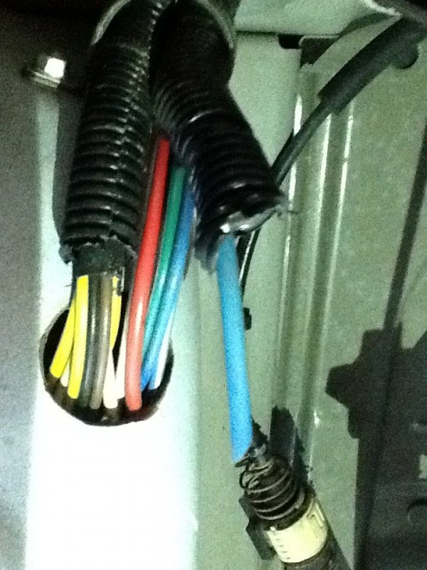

Nice officer "noticed" that I had no lights at the back of 2008 3500 Express Motorhome
so 4 way to campground
book said fuse 15 for tail and backup
nope fuse good and when pulled BU still worked- go figure
got home by driving day only
got under and discovered under drivers seat- Body fuse box area where the FACTORY cable comes out a jagged hole with NO bushing
BIG blue wire cut which may be trailer brakes- maybe some more (like tail lights)
going to disconnect battery, remove seat etc and do some investigation
I'd suggest everyone take a peak under their vehicles in this area and report
The wire loom stopped before the hole so it did no good there
cheers

Maybe post pics to help teach the next guy what to watch. Betting that wire theough brake controller circuit is your issue.
just had pics taken, will post up later tonight what I need to know is if Chevrolet routs wires straight down through sheet-metal under the seat through about a 2" hole or is stock out the back or somewhere else Is this a Chevrolet Problem or the Motorhome builder problem

Schematic show the wires as GM back to the rear axle area where there are two connectors for builder however builder could have re-routed the gm wire where it leaves the under seat fuse box
several hold downs are not in place

If GM did the hole it would have been stamped- that was clearly cut.
GM does not use split loom.
Totally builder hack job.
Repair the damage, put in quality grommet, test everything working proper. Then seal up with permatex the right stuff, or better a quality body cock. Do not use plain old silicone.

builder went bk in 2008-9 timeframe
GM wiring diagram shows wire to rear
going to the wrecking yard to see a couple of other vans and see how GM would have routed
will not be able to move motorhome to place where I can disable for about a week then pull fuse box and loosen cable and pull up enough so that I can see all the wires and fix whatever
not only clearly cut but a rough jagged cut
I rent space to a auto electric shop and a body shop so we'll get it done right- which means I do it myself :)

turns out hole was under drivers step not under fuse box
wires change color 3 times between taillight and connectors near rear end
don't you just love it
there were three cut wires but they may just be builders not used dead ends as there were no matching on cab side of hole
go figure
Rewired the taillights
There was no +12 to the rear (as shown for the trailer hitch)
The only working tail light was a SIGNAL in socket F (small wire) in the Chevrolet 10 way connector
(which was Mickey moused into a 4 way connector with a large gauge wire running forward and another large gauge brown wire with black stripe also running forward- neither appeared working- they could have if there was a Fleetwood relay up front somewhere but we could not find it.
so we installed a 30 amp fused 10 ga Red+12 from under the seat fuse box to rear and fed a relay with the +12 and the existing Chevrolet SIGNAL (there are other signals for other trailer lights (back up RT LT so Chevrolet expects them to be on relays)
The Chevrolet SIGNALS are fused and Relayed under the seat
