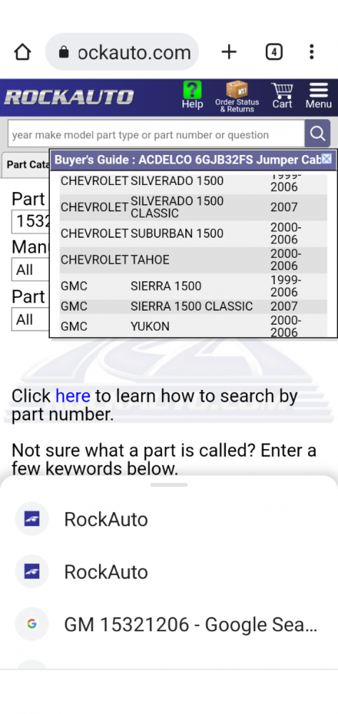

Can you buy the fusible link separately?
do you have a Napa locally in your area? I know it might be a little higher in cost, but they usually will make cables to your spec. they should also have fusible links too. Just keep in mind what the operating current the cable needs to carry. the longer the cable, the larger it needs to be to support the amp draw and not begin to heat up. the fusible link not so much as it's usually short and rated for the application, you just don't want the cable to limit the flow!
I'm missing it. Current application is replacing a generator.
If anyone knows of a longer OEM cable, let me know.
