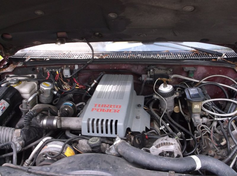

If I use this, how do I bleed the fuel filter? It looks like the line has to come loose every time I would bleed. Is that right?
If you've already addressed this, Leroy, in another discussion, then can you point me to it and sorry if I missed it.
Sorry just saw this.
With a flexible hose you can just loosen the FPT same as you would the plastic air bleed. I have mine on a tee, so one side go's to gauge and other with a valve to a hose that I can direct fuel into a container.
Not best pic, but I think you can see what I did.
