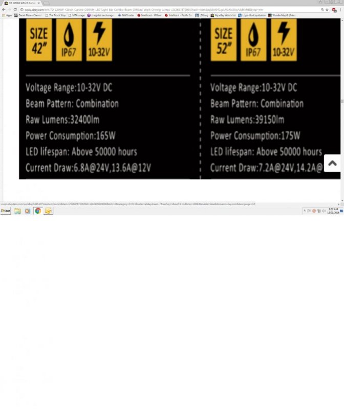

So I'm looking at buying a light bar for my truck. My ? is about current draw. Looking at one advertised at 1296w which translates to 108 amps the pics of the wiring harness shows it uses a 30 amp fuse. How can that be? Am I missing something or is it false advertising?
Often they use it as a comparison to a regular bulb ie: it may have the same output as a 1296 watt bulb.
Perhaps this is the new Common Core math???
My hand calc is coming up with:
80 LED's * 6W = 480W
480W / 12v = 40A
So, how is that thing supposed to work with a 30A fuse?

I was looking at 2 different light bars it has 216 LEDs first part of the ad says 6w second part says 216 x 5w and the lumens are 200880 I was going by my foggy memory before
That looks like way too many LED's. I'm guessing you're looking at a 42" Bar? Just get a standard twin row, 42", combo beam. Although Philips and Osram LED's are some of the most common, CREE LED's actually outperformed them, when used in a combo pattern.
it an estimate on the watts. LED's aren't measured that way.
