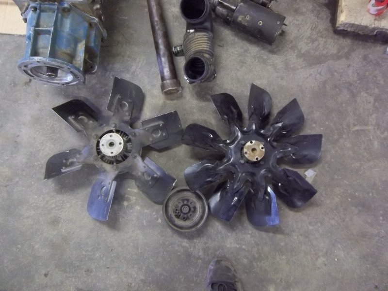

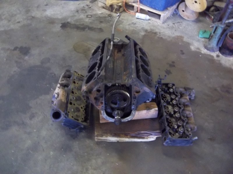

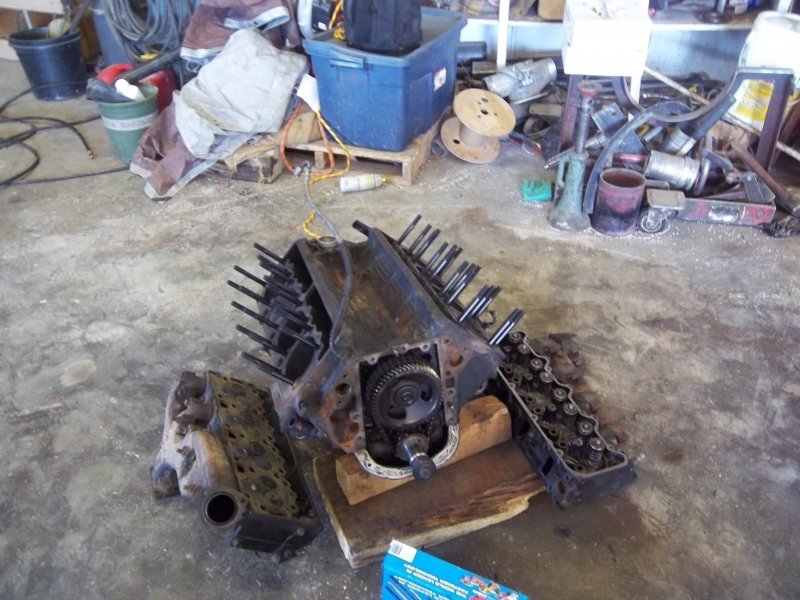

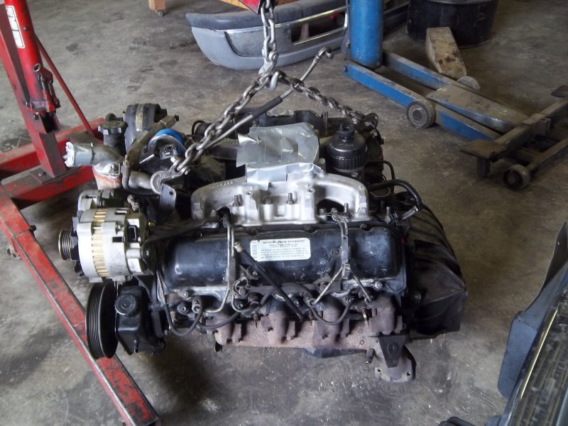

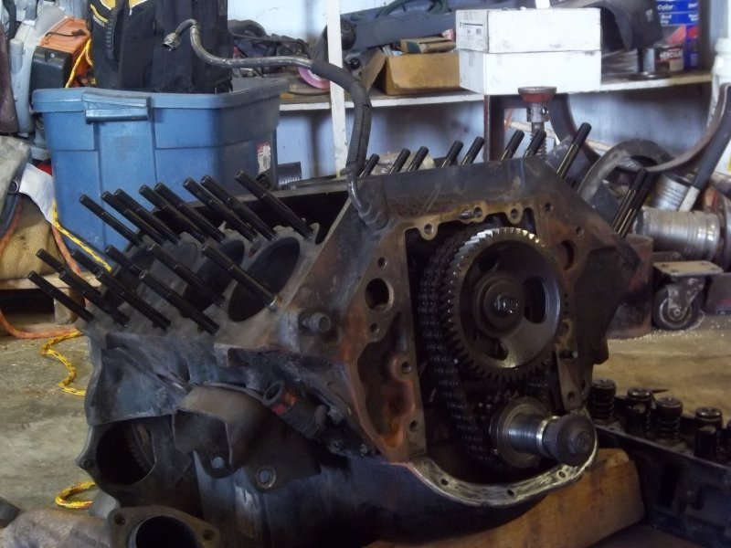

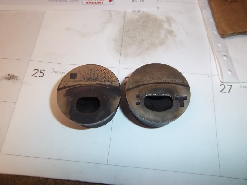

Well, a while ago I did finally get around to installing a set of ARP headstuds from leoydiesel. While the heads were off and the motor was out, I also swapped from square stamp NA precups to turbo T-Stamp cups out of my old 599 block. I also picked up a spare motor that I think is a 141 that I robbed the fan off of. The block was completely flushed out. Here are just a few pictures.
