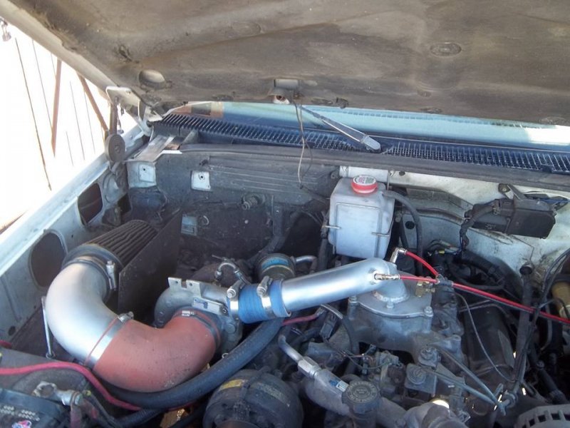

Also a somewhat updated picture of the motor with an updated intake I made and somewhat of a heat shield. I also remade the waste gate to a much better design (not pictured) and re-routed the CDR back into my intake instead of dumping to atmosphere.

Removing the A/C accumulator, and relocating the coolant bottle free's up alot of room on that side of the engine. That is a sharp looking ole truck you have there!
Matt
I just realized that thumbnail of the motor cuts the picture in half haha and yeah, it does open up a lot of room. I had to move that stuff to make room for the BD Diverter Valve and now that it's gone, just have no need to move it back. I actually like my overflow tank being where it is better and having no accumulator is epic nice. Not that my A/C ever really worked anyways since I got the truck, so it was easy to make the ditch with it, but not having it there makes such easy access to so many things!!! hahaha and thanks for the compliments. Lot of time and hard work has gone into her. Not to mention probably more money than I'd like to admit at this point haha
