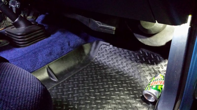

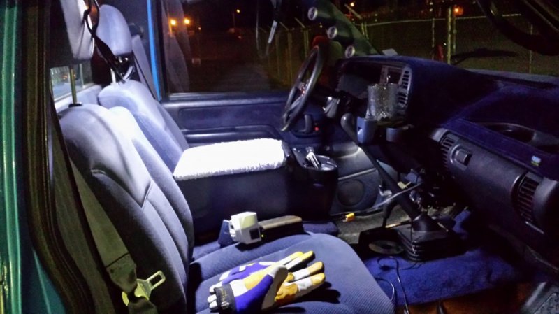

I put a couple of these in my factory dome light housing: http://www.amazon.com/gp/product/B00FKPJJNY/?tag=jhuntlink-20

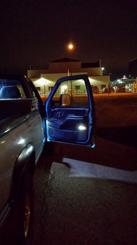

Two are overkill, but can't argue that they light things up. Practically speaking, to the point, I think it unwise to light them going down the road at night as it wrecks the driver's night vision. On the plus side, you don't need a flashlight to find something dropped on the floor anymore :)
For reference, the interior light pictures were taken same time of night as the one showing the door reflector light.
I like the flat 48 smd panels for locations where there's a flat surface behind lens. They come with double sided tape & several adapters to use the OEM bulb's power source.
Bought these to replace many of the 194 size bulbs. Some locations require some trimming as the upper portion is considerably bigger than 194 incandescent, but good price buying 20 & they give a nice white light for floorboard lights, license plate lights, door reflectors, etc.
http://www.amazon.com/gp/product/B00N4GJHJ2/?tag=jhuntlink-20

Forgot my dome light is in an overhead console out of a newer Blazer, so may not be room in GMT400 dome lights for the 48 smd panel? But great light output where you have room to place them.
I also used the 20 smd 194 style bulbs in the console's 4 map lights. Took a little trimming of reflector. These 20 smd 194 style LEDs aren't maybe quite as well adapted for directional light as some of the more specific purpose shapes, but they're a lot of light for the cost & the applications I've used them in pretty much shield the light so only shows in intended directions.
