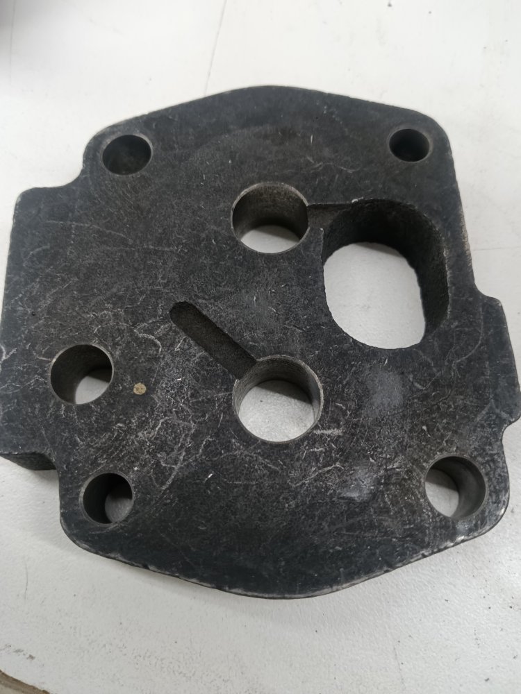

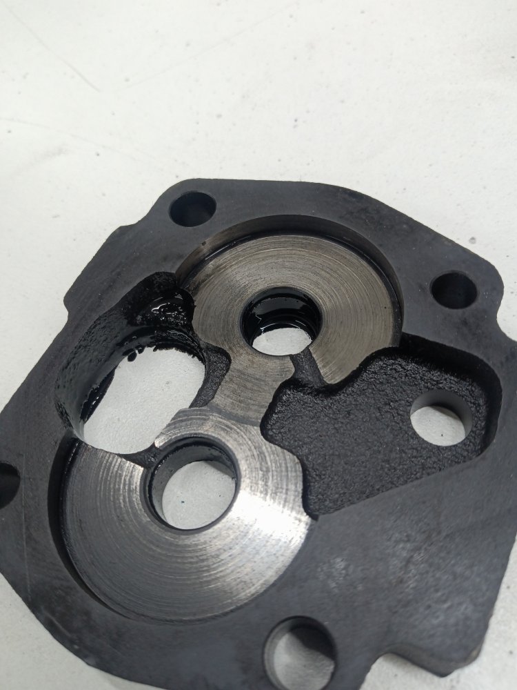

But I can’t remember or find my notes on the oil pump itself. When you refinish (sand down) the surface of the gear plate or body to tighten the clearance- or refinish the gears to open it up.

gear end play spec is 0.004-0.008
Gear : housing side is 0.002-0.005
Tighter the better for increased efficiency & volume.

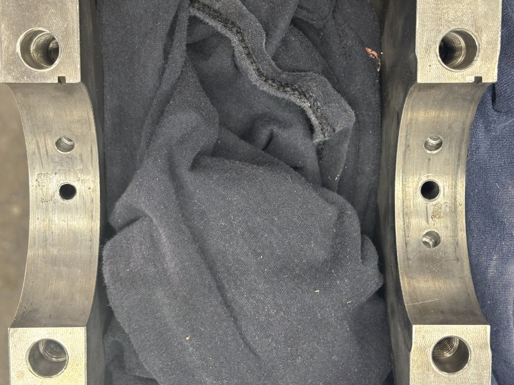

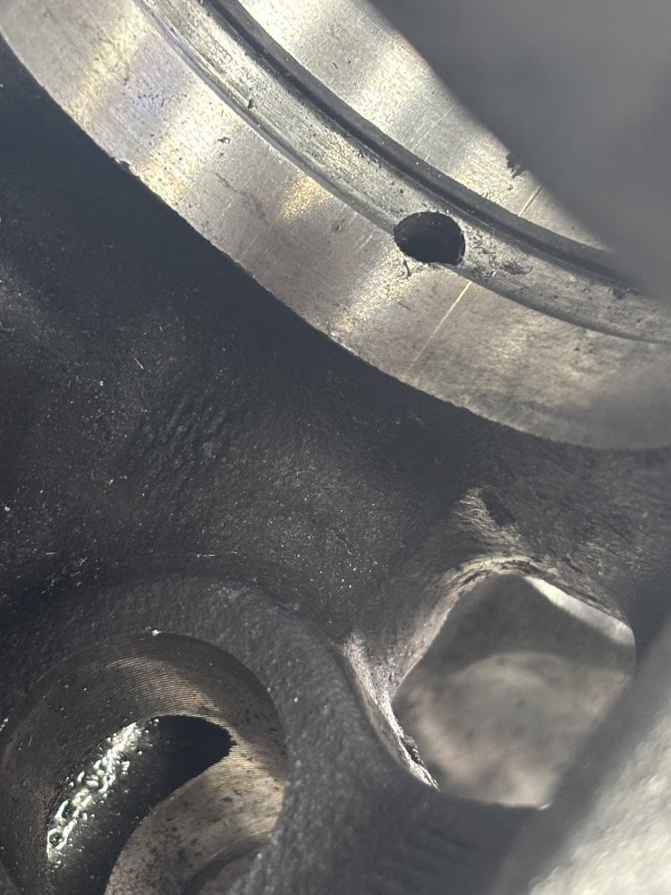

An example-I drill the 3 middle main cam to main journals to bit G size. Then the bearing to size H which is 50 thou larger so oil cant push behind it and cause a spun bearing. I drill all 5 holes from cam journal to cam bearing same way. All 5 cam bearings can use better oiling. But the 3 mains in the middle have 2 rods they supply while two end mains only feed one connecting rods each. The real is already large than the front because of the way the rear main seal works.
Look in the pic and you’ll see main 1&2 and see the larger drilled hole. Both chamfered but not yet sanded smooth. Pic 2 shows I haven’t yet drilled the cam bearing feed, but will. You can also see I have done 1st stage of cleaning up the oil return passage of flashing and helping the ramping of that path.

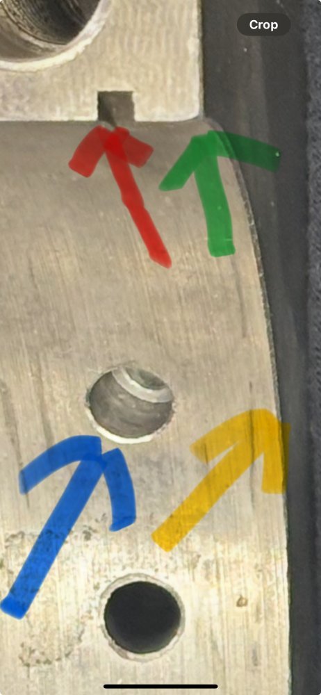

Just because the pics are here, a zoomed in pic to teach whoever…
Red arrow where bearing tab goes is never altered. See how sharp the edges are.
Green arrow you can see I “broke” the edge. Basically file off the sharp edge. Sharp edges are where cracks start, and micro pieces chip off and are debris in the oil.
Yellow shows same thing all the way around the main webs, almost the entire engine gets it. Only a few specific locations you don’t do it- but some builders do everything, everywhere.
Blue arrow (at the oil squirter port) is easily and quickly chamfered to break the edge with a large diameter drill bit or tapering bit. Low rpm, 2-3 revolutions of the bit is plenty. Very low pressure on the drill.
Then later some emery cloth or sandpaper folded over finger tip- just put fingertip on hole and twist your wrist back and forth 3-4 times on the holes. The edges just a couple simple wipes over the edge. Think of it as cleaning off the micro corners that is created.
Magical wand theoretically is a rounded over edge so small you can’t see or feel where top turns into side.
Many people don’t even bother with that secondary step. But you can use ten cents worth of sandpaper and do every part if a block and head after the edges are broke in about 15 minutes.
