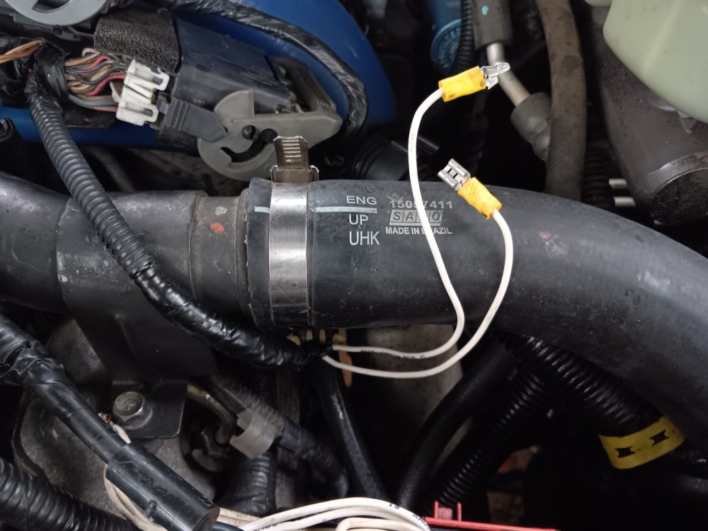

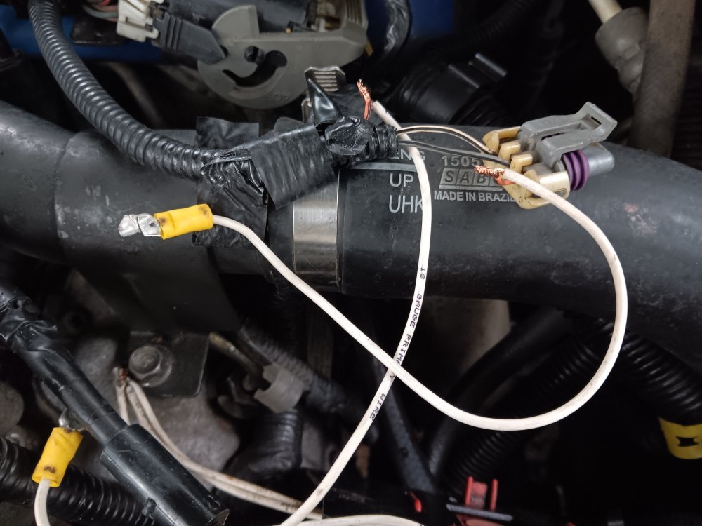

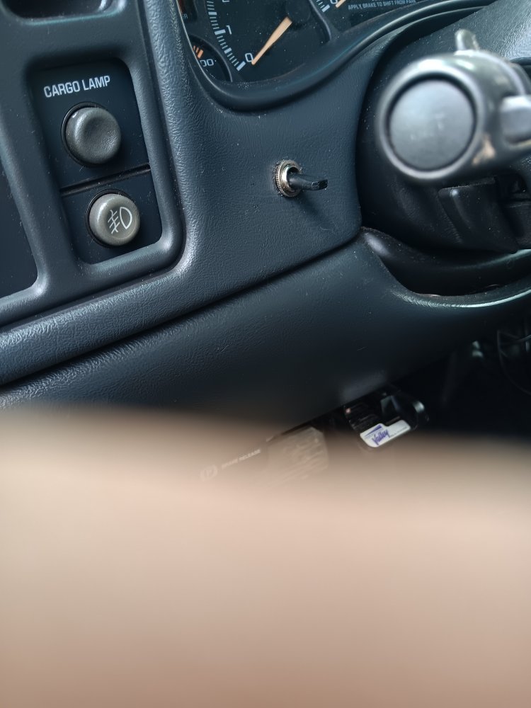

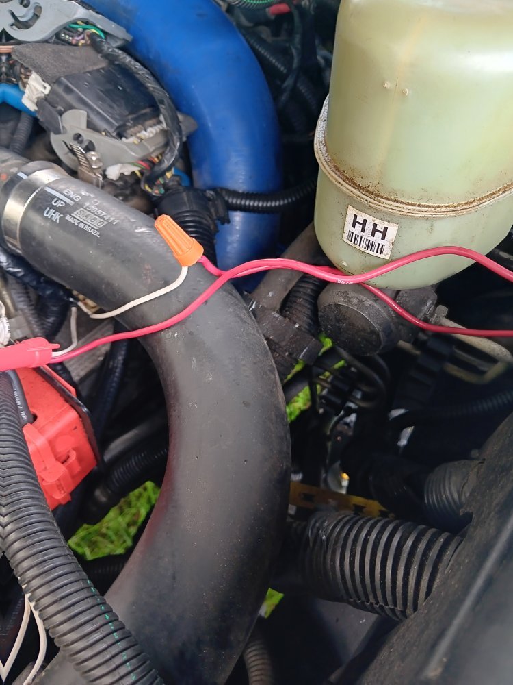

Howdy yall. I bought my dream truck about 3 months ago. 01 Lb7 dually. Along with it, the dreaded "P0093" code, and limp mode mainly while going up a hill or towing. Lomg story short, after doing everything but injectors, "I was told they were done bot even a year ago" it STILL put me in limp mode. I done fuel lines, filters, bypass filter housing, FPR, FPRV mod, tuning, lift pump etc, still no luck...I was frustrated and dome some reading on the 'bugs" that the 01's have in the tuning. So, the other day I read about the BARO sensor, and what it does. It supposedly adjusts fuel trim depending on the readings it gets, and they can get wonky sometimes. I unplugged the sensor, and FINALLY, the actual rail pressure would keep up with the desired pressure..blew my mind. But, the baro sensor is tied in with the map sensor "boost gauge" and they didn't work. So, I made a splice in the oarngish/ red wire, and put it on a switch so I could cut the signal of it, but still have it plugged in and the baro gauge work along with the map sensor....works like a charm..with the switch off, the truck runs like it should, no issues, no limp, no de fueling, etc. Blows my mind why or how this worked, but it did! Maybe it will help someone with this issue. I will include some pics of what I done to get rid of the limp mode. Maybe a new baro sensor would fix it, maybe it's bad. Maybe it's "Maybelline" lol but it worked for me. And I'm leaving it ALONE! LOL By the way, my EGT'S are down also on average 100 degrees. And I'm running an edge tuner on tow mode, and using the monitor to watch parameters. I also have an analog boost gauge and pyrometer I installed. Hope this helps somebody. Much respect.

Cutting that sensor is putting you in to engine protection mode, so it is not fueling as much, that is why your rail pressure is now holding. Has the ECM been updated? There was many problems with early OS's setting rail pressure and boost codes for no reason. Otherwise you need to have a return rate test done to see where the fuel is bypassing.
And "new injectors" does NOT mean good injectors. So many "remans" are worse than 150k mile worn out injectors it's unreal.
Well. As I said, now, when it demands 21k, it will hold 21k. When it wants 22.5k it'll hold 22.5k. No engine light, no codes. Pulls like a train. Whatever the TPS tells it to do it will do. If it's indeed in engine protection mode, there will be "thresholds" on all parameters. I'd like to know what they are if so. Cause it does what it's asked to do now. At times, I can mat it, it'll demand 22kish and it'll do 22kish. Till I let out. I ain't arguing, it's just weird. It's like the TPS is not sending riggt signal, or communication is being lost somewhere, whether it be at the FPR and it thinks it's at the number it's supposed to be. Either way, now it runs as normal as my 03 LB7. That truck never commanded 21k rail pressure at not even quarter throttle like this one when I have the switch in normal mode. I flip switch, cut that one circuit, and all is well. Digital boost gauge still works, baro sensor still works and reads as it should etc. Thanks.
