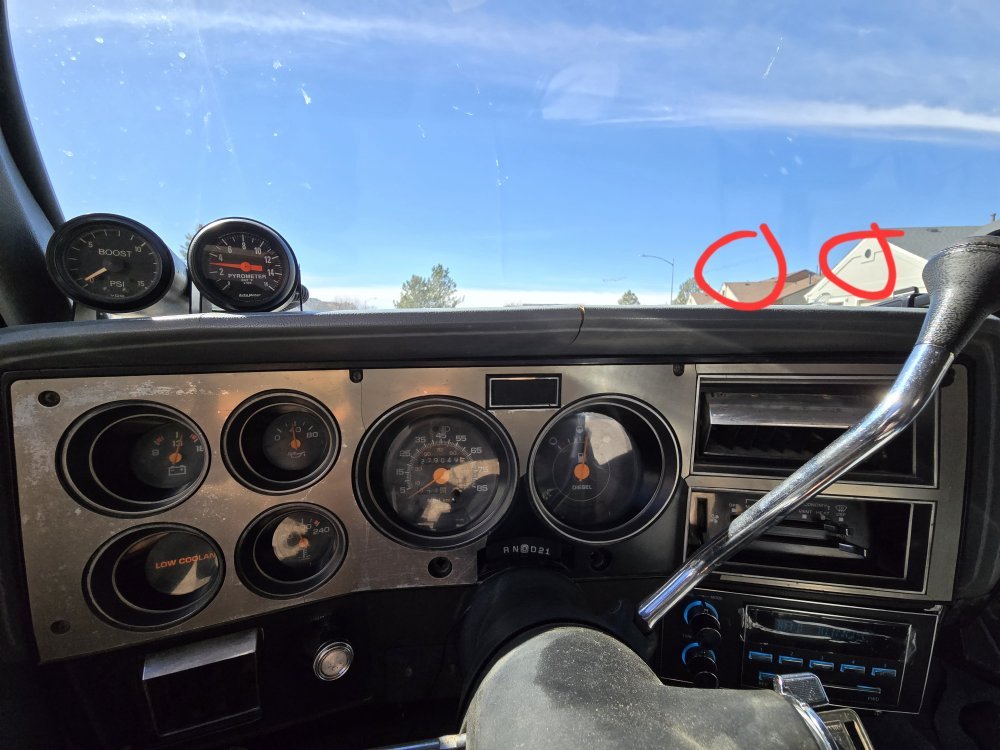

When I cruise the PSI stays at 3 typically, if at all slignt incline or putting my foot on the pedal it'll go to 5 PSI, but i keep an eye on the temp and oil pressure guage aswell.
I only ever rolled coal today, and even then it was slightly, and when going up steep incline (https://photos.app.goo.gl/Cxf2yAciNjtcW3MA9)
The photo attached shows the guages/layout i have, not including the transmission temp one that i have yet to install

@nycxjeremyy I'm curious... you are running a 4l60E. what are you controlling it with?
keep in mind that the 4l60e is the weaker transmission. that 6.2 has the torque to blow that trans up. you might look into at a later date getting a 4l80e or having that 4l60e built up to withstand the torque. this might have something to do with your power loss.
this is boost pressures your talking about or fuel pressure? if boost, you need more boost under load. what are you using to control the waste gate?

It's a Stage III 4L60E, it's not a stock GM one, I even run an external Hayden cooler with it to keep it cool, also, I control it with a US Shift Kit controller, the Transmission was built by Gearstar
Boost pressure sir, and, honestly no idea, never touched the turbo, that was all previous owner, the link in the OG post i made shows the paperwork by the shop from the previous owner
