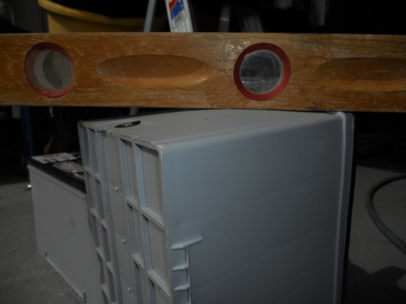

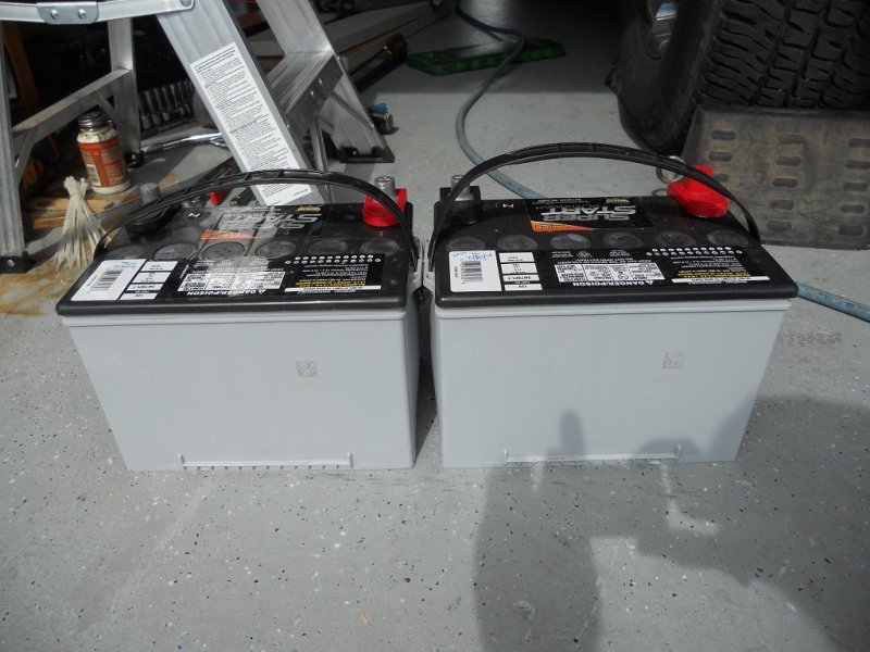

My bad I didn't post pics of the batteries trying to burst. Note swelling of the sides!
