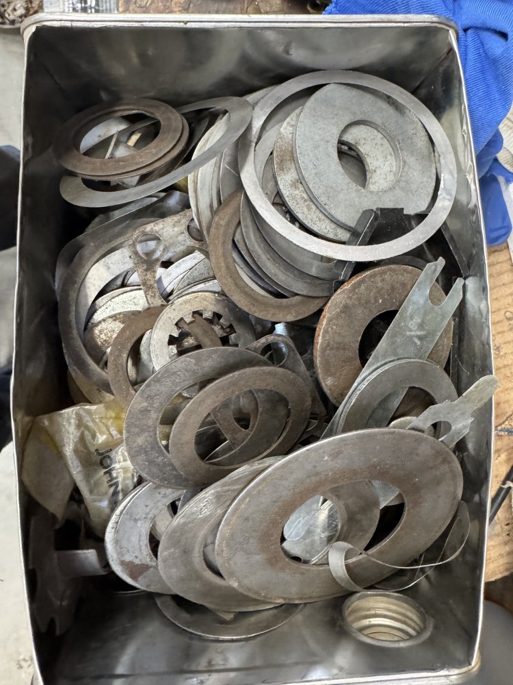

there was also a couple of really think nylon shims in there which helped take up some slop. those might need to be replaced with some real shim stock. it still has some wiggle room for some extra shims. the shims are about the size of a fender washer with about a 1/2" hole in the center and about as thin as a sheet of paper. I need to look online and see if I can find some metal shims like that.
