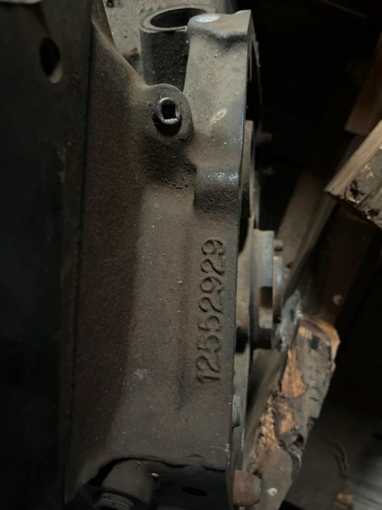

The 929 is a 6.2 I believe with the 2 piece rear main seal.

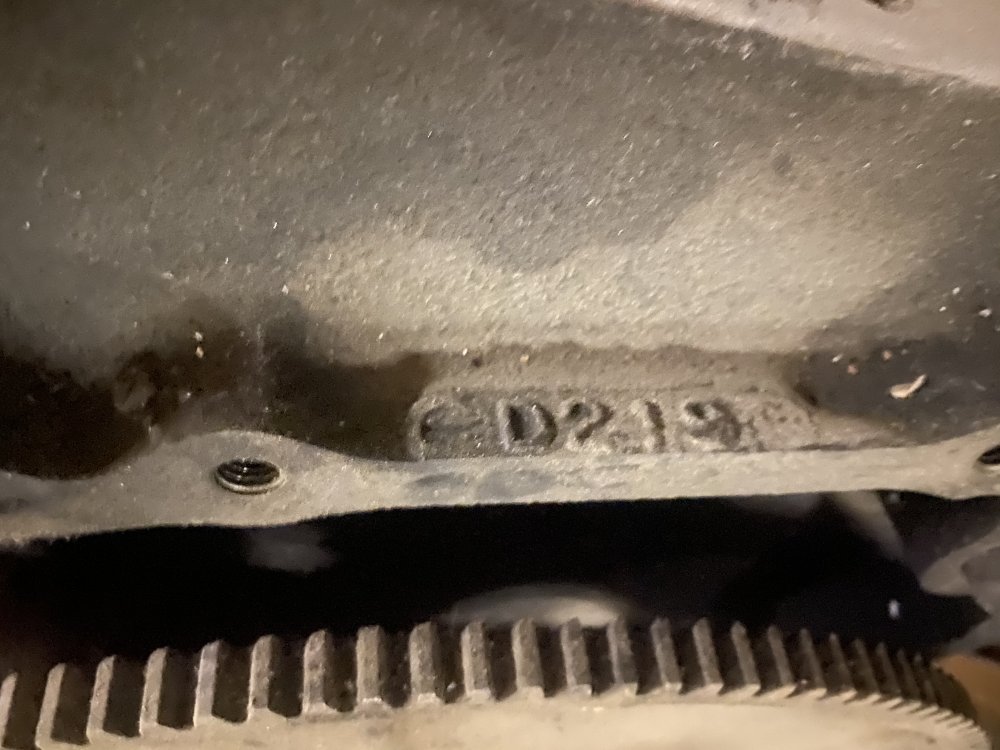

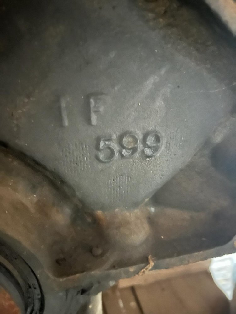

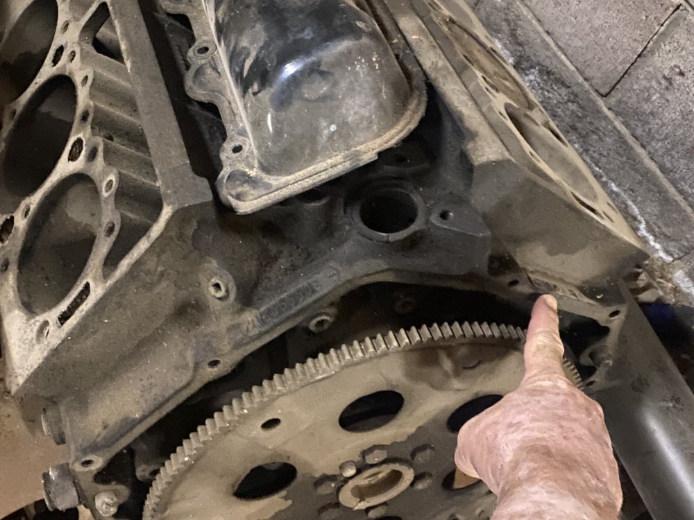

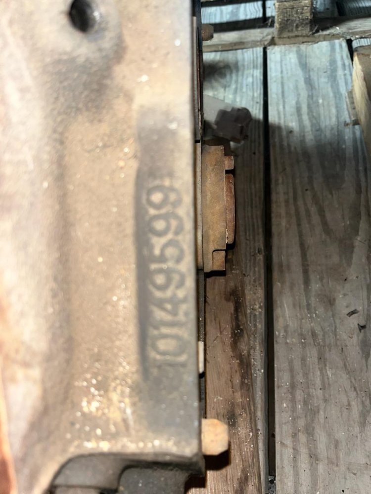

The 599 is a 6.5, need the julian date code on right rear of engine near bell housing bolts to identify better. The 599 is the number from the early 90’s to today’s production. Could even be chinese knock off.
Pictures help also.
