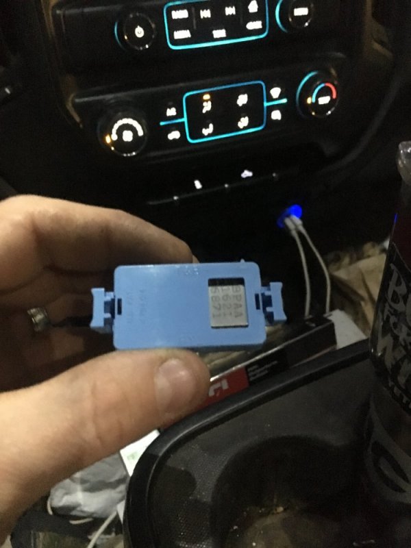

I purchased the truck in my sig in the spring of 2016, and it came with an extra tune. I was told by the owner that the truck currently has a "buddy" chip in it, which form reading the forums here I discovered meant that the chip came from the member named Buddy. I have no problems with buddy's chip, but I'm curious to know what this other mystery tune is.
The chip is stamped with the following:
BNTK
1621
5278
If anyone can identify the chip based off that information, I'd appreciate the insight.
thanks!

I am not seeking info on Buddy's tune. That tune is currently in the truck's ECM. I'm looking to find out what the spare tune is that came in the glove box. It could be the stock one or any other kind for that matter. I just want to know what it is so I can decide whether to hang on to it or not. The previous owner told me it was a "towing" tune, so before getting all giddy that I was given a free KOJO tune I sought help here.
There's a picture of a KOJO tune chip on walking J's website, and the numbers are different from what is on the spare tune. Perhaps I incorrectly assumed that all of a certain tune would be stamped with the same #s to make identification easier.
If the #s are irrelevant WarWagon, is the only way to identify by sending to someone with the software to read the chip? Do you or anyone else know what the #s on a stock chip from this year are?

I would call walking j and Heath and whoever else makes tunes for these trucks and give them the numbers and see if anything comes up.
Whoever made it should be able to tell you what kind of tune it is.

There was no standard for aftermarket chips. Buddy marked his as he pleased. I suspect you may be looking at the OEM stock chip, or maybe a different tune hand marked by him. (I have one of his 6 banger tunes.)

Sounds like the chip that you identify may be the stock tune chips that come with the truck?
I am not sure if we can actually dump the data and read it, though.
There should be a software/app but I am not sure if that is widely available.
What you can do is try to get in touch with somebody who have access to the apps to read the data.
May be Buddy, KOJO or Quadstar.
As far as finding if the one installed in your truck now is Buddy's, you need to get a hold of him directly.
Again, members here do not have that capability.
The 4digits and numbers look like a GM oem chip, BUT anybody could have erased it and flashed there own tune onto it. In that situation there is no way of knowing what it is. If I understand you correctly, you have the ye who shall not be named chip in it now, but you're trying to identify the spare chip that came with the truck. Most aftermarket tuners normally start with either a new BLUE blank, flash it, and hand write the info on it, or they use a chip that doesn't resemble the stock eeprom at all, and use that one. Some tuners would re-use oem chips, erase them, then flash them with a custom tune, and use it. You may jave one like that, or it may be a stock chip. You're looking at around $100 in hardware from Moates to be able to read the tune, then you have to hope you can find somebody with a stock BNTK bin file to compare it to so you can see if yours is stock or not. Otherwise there isn't much of a way to find out as there isn't many out there with the stuff to work with these chips, and even fewer with the files and willingness just to check a chip to seeif it's stock or not.
