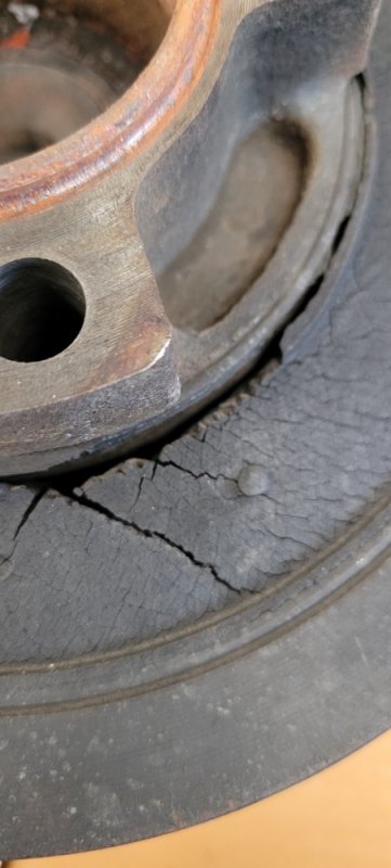

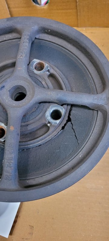

I have been following/buying parts from LeRoy Diesel for the past 2 years. one of his recommendations is to replace/upgrade the Harmonic balancer and pulley with a solid one he sells. I ordered the 2 items from him and finally after it sitting in my garage got around to installing. Should have been #1 priority! The hard rubber piece he talks about failing had done just that! IT was completely separated and spinning freely! What kept it from coming completely apart I have no idea. If you are still running with the original in your rig, DO NOT wait any longer! Best money spent! I have also upgraded my water pump and fan, re-located the PMD to the front bumper. Up next: New lift pump and wire harness.
