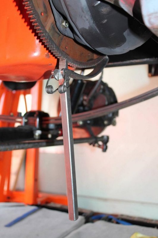

I take a pair of allready-bent-numerous-times pulley damper bolts and tighten them down on some pipe spacers and washers, and put a prybar in there.
It is also quite handy to grab ahold of when you are going for the 200 lb/ft with the torque wrench.
