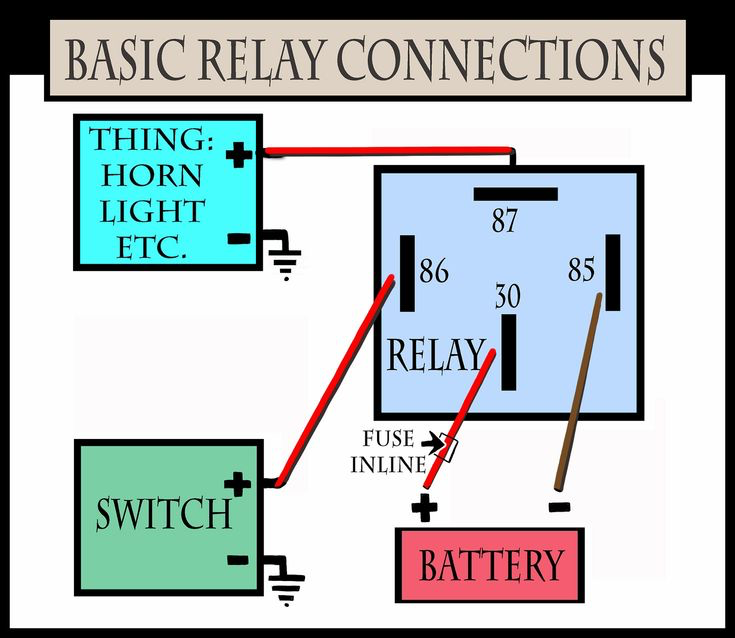

Since you sound familiar with doing a relay unplug the lift pump. Run wires back from the plug that supply the lift pump, that hot wire will go to the exciter on the relay.
Then run back from the relay to run the lift pump.
That eliminates the cutting and splicing.
Basically, you can use whatever schematic for the lift pump relay upgrade you find. This will just change your to and from and make a cleaner installation
And a momentary switch can be added to the relay harness system, that can be used to purge air from new filter installations.
Here is a simple relay system.
And here is for a five pin relay switch.
Someone smarter than Me will have to explain which circuits needs to go to which pin.
IIRC, 87A is hooked to the momentary switch then is spliced into the live line to the LP.
