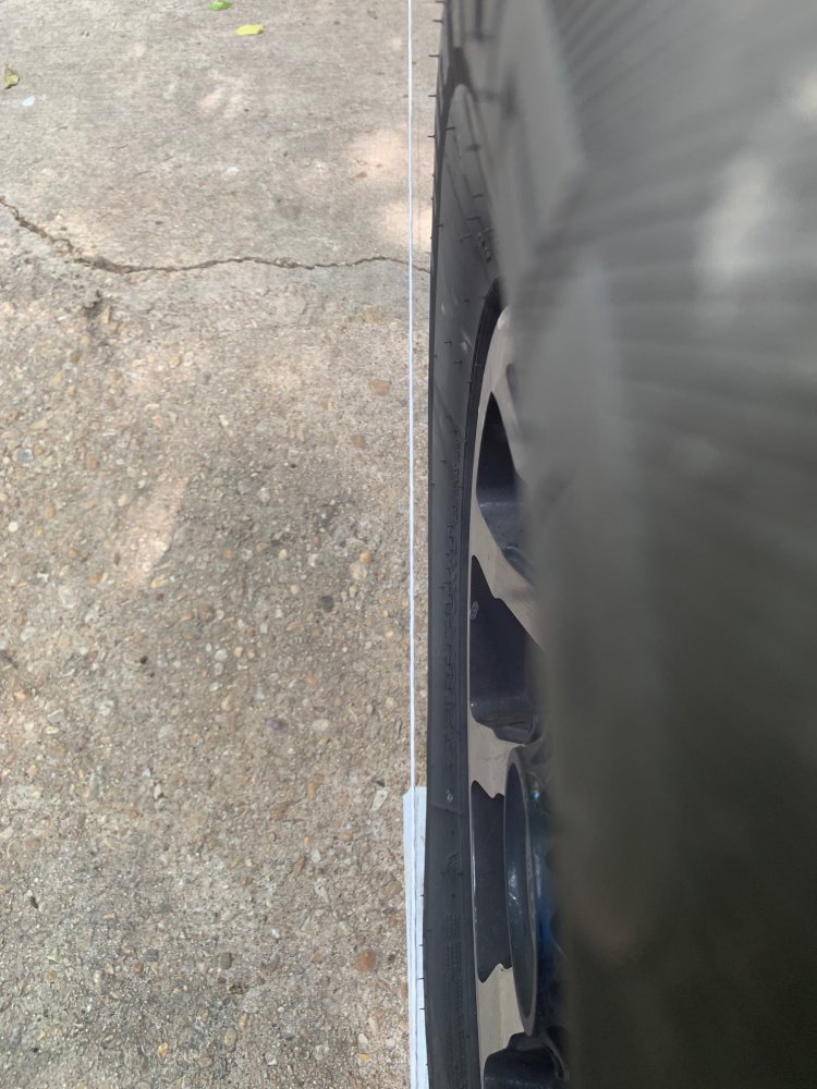

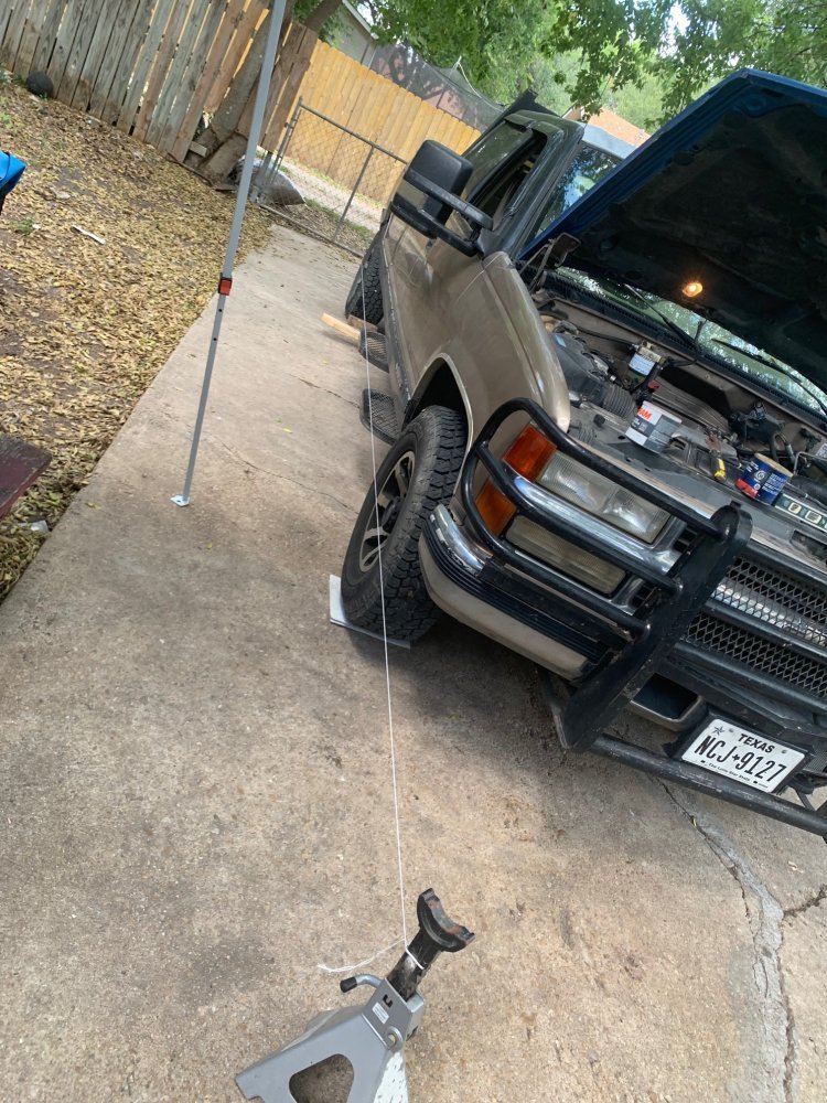

when I adjust the toe I normally set two jack stands forward of the front wheels and tie a long kite string to one wrapping back around the rear wheels and up to the other front to the second jack stand, pull it tight along with using a twig between the string and tire at the far rear giving a space so it's not touching the sidewall. Then use the rear rims to measure the distance front to back of the rim adjusting the stands closer or farther away to get the strings a straight and in line with the truck as possible. as long as the wind isn't blowing too much I can get it perfectly straight.

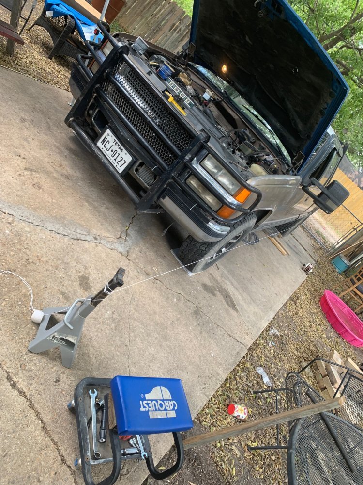

Then I move to the front wheels and use the rims to measure front to back of each wheel, taking the difference giving me my toe in/out measurement. also making sure the steering wheel is straight with the wheels. I did all this and I'm now perfectly straight with a 1/16" toe in.

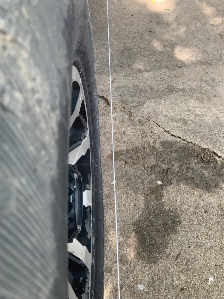

something I ran into which the truck has been like this from the day I purchased it is the rear axle is off set to the drivers side by almost 1 inch. you can see this in the distance of the string on the passenger tire comparing to the drivers side. not sure if this can cause an issue or how I would go about fixing it if I need to.
